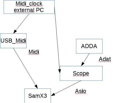

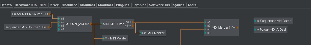

Find attached the description of my setup.
SamX3 just uses the external Midi-USB-Cable ( like Midimate) and the scope setup runs as shown in the background.
Everything works.
Now I connect one of the midi dest on the right. Now SamX3 looses asio buffers.
Either samX3 cares about midi-interfaces it shouldn do or scope does some strange coupling between midi and asio.
Do you run a similar setup ?

I think I found the problem:
In my scope7, there is a scope-15dsp card and a pulsar 4 dsp-card. I used the midi-ports of the pulsar, but the Adat is connected to the scope-15.
If I use the midi-ports of scope-15, there is no problem anymore.
So I think, it is a problem of scope in combination with my setup.
I'll do some more tests, than I'll drop a line to S|C.
Why this only happens with samX3 ? I have no idea.
Re: samplitude DAW crashes with scope
the 4dsp card may not handle the midi clock traffic as well as the newer card. there's probably not much that SC can do...
