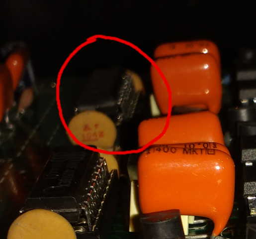

As i've mentioned in another thread, i've dug up my old Elka EM22. i bought it 10-12 years ago, and it has basically been hidden away in my basement.
Im considering trying to fix it. When i bought it, it seemed that the former owner had put it in for service once, as one of the chips was marked "def", which i interpret as defective. The chip is marked in the attached picture, and the service manual describes this as a "192 word x 8 bit cmos static ram".
symptoms:
I have it hooked up to my daw, and fed it with chords and arps, with constant velocity. basically, the notes seems to play at varying velocity, and sometimes not at all.It has 6 voices, and a 1+5 split mode, and the issue seems to be consistent on both parts (arpegging the bass will miss a voice here and there, chords will miss a voice or play the voices at different velocities). symptoms are similar if i just arp the bass, just play chords, or combine the two.

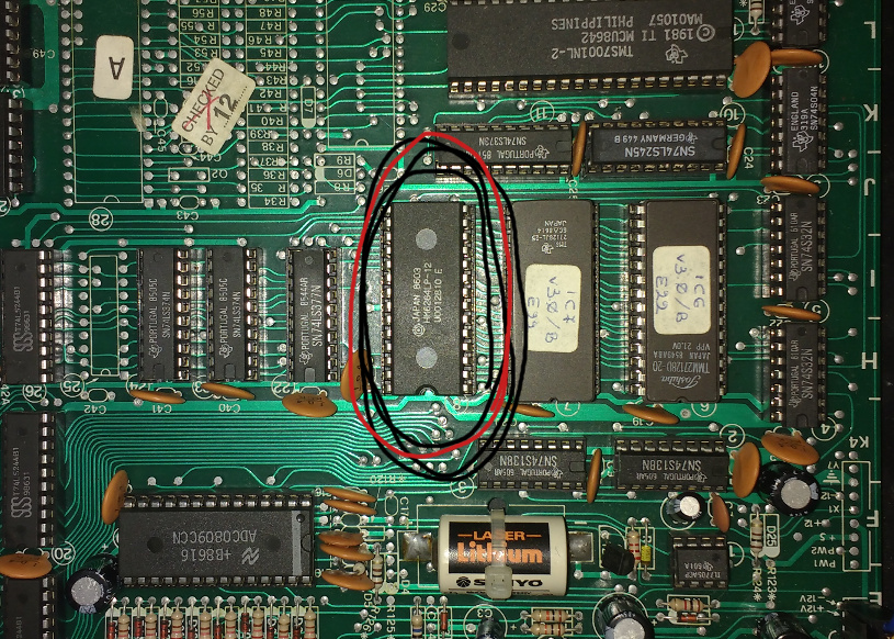

1. Im not very familiar with instrument electronics. I know my way around synth basic theory, but at hardware electronics i am totally blank. So can anyone tell me if the the chip i mention being broken would result in the symptoms i have noticed?
2. If this chip might be the culprit, i did some googling and found a supplier that seems to be able to supply a spare, see https://www.utsource.net/itm/p/1097270.html . I notice the pictures they supply has some different numbers on them, but if i supply them a picture of the chip in question and they send me a replacement they say will work, would it be safe to just swap it? Maybe someone can recommend a different supplier?
3. I bought this thing for 60 bucks long time ago and i am unsure of how much this thing is worth, and therefore how much resources i should spend getting it up and running properly. I see there is one up for sale at the moment, but googling the sellers text reveals it is a copy of an ad from 3 years ago, so i am not sure if it is a realistic price or if the seller is real at all. Anyone have any experience with pricing this kind of stuff?

Well I have had some educated input that my prime suspect probably isn't the guy to blame. I will continue my research, but if anyone have input, please feel free to chime in :)

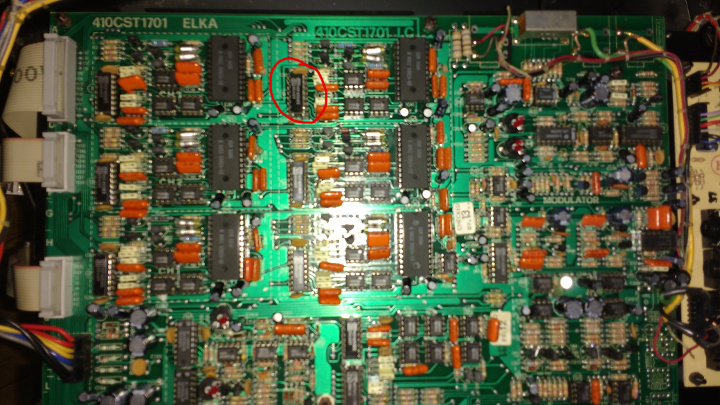

I have been talking and getting some input from some competent guys, and the bad news is that the problem most likely is with the voice chips themselves (cem3396). The good news is that they might not be that pricey, I have located a source in France that apparently will sell me a set of 6 chips for 80 euros. I have sent an email to check if they have them in stock. But first, i need to slaughter this box a little bit more so i can re-seat the existing ones, and switch them around so i can see if they indeed are the problem. One might be bust allready, the others might be failing, and if the pattern of dropped notes etc. is coherent with how i switch them around, they most probably are the issue.

If you are planning on doing this yourself, your first step should be to check the continuity (fully soldered down to the pads on the board) at all of the connections of the chips with a multimeter. If you have schematics for the chips, and can access them under power, you could also check that the ground and voltage inputs are good and registering the correct values. Include the questionable RAM chip in the process as well. If you have a way to check them, any "clock" chips should also be evaluated because a slightly erratic signal from one of these could create the result you are describing, although a multimeter isn't much help here beyond checking the continuity and voltage/ground. It can't help with the quality of the clock signal (oscilloscope for that).
It sounds like you are getting excellent advice, and apologies if I'm suggesting things that you have done already, I'm not clear on your exact skill set. Swapping the chips around has some inherent risk, and it's possible to create more issues than already exist if you aren't careful.
If you do get to the point of swapping the chips, you should consider changing the ram chip as well, depending on cost, etc. just to be sure.

Thanks for the advice, i think i have the complete schematics, although i haven't checked in detail. I do have the pin layout for the chips, so it shouldn't be a problem to identify the ground pins etc. To clarify, i am a novice when it comes to electronics, but i do have have basic understanding/education in the subject, although it hasn't been practiced for, what, 20 years? So regarding powered down systems i think im ok, although i am a bit skeptical to fiddle around with currents running :)
The risk of swapping around, is the main concern mechanical damage?

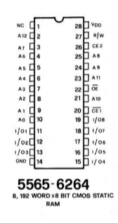

Regarding the ram chip, i have traced one down for less than 3 dollars+pp, so if i can verify that it will be compatible i will swap that one too.
My original plan was to this myself, of course that was when i had identified the ram chip as the problem. I think my revised plan is to first do a visual check of the chips to see that nothing has popped out during moving, buy a multimeter (i guess that describes my skillset :) ) and check the connections. If mechanical damage is the main concern with swapping the chips around i will probably do that as well, i guess its the same hazard as fitting new chips?

So i dismounted the top circuit board today
And guess what....
So this little fucker wasn't completely fitted in its socket! I took it out, straightened some pins that was clearly bent, re seated it, and hey presto, I have a fully working 6-voice analog italian synth :D
