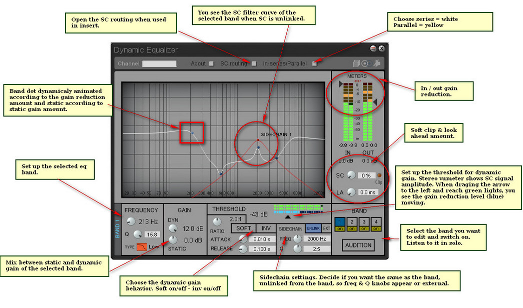

With this fantastic TrrRRremendous dynamic eq, you can separate (unlink) the SC signal from the eq band to modulate its gain. You can add static and dynamic gain to each of the 4 bands, or a mix of both.
If you add positive dynamic gain, the gain will rise, modulated by the SC amplitude signal. With negative gain, you'll lower the eq band gain.
Each of the 4 bands have parametric / high shelve / low shelve filter choice.
You can use external SC source signal for each of the 4 bands even used as insert.
A « soft » button to make modulation transitions more sweet.
A « inv » button to reverse the dynamic equalisation : the dynamic gain is applyed when the SC signal goes above the threshold.
Comprehensive vumeters showing the SC signal amplitude and the gain reduction.
A look ahead knob.
A softclip knob.
Choice between parallel and series for the 4 bands (in series = 1 → 2 → 3 → 4)
You can listen to the SC signal on each band.
The latency between SC signal and gain modulating is 7ms at 44.1khz, and always the same !

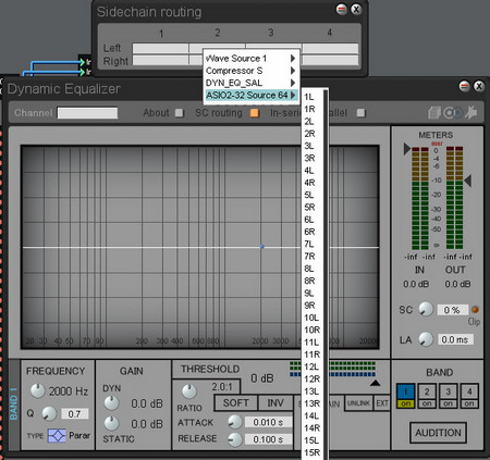

I show tou the device in the project window :
And the side chain routing window opened to route side chain when used in insert :
