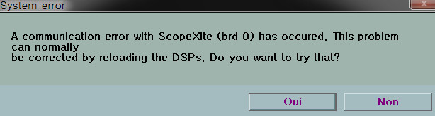

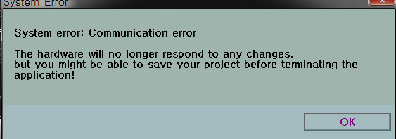

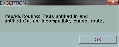

It started again !!
The 1° message is :
Then :
And then :
What is this ?? I bought a first class HDMI cable 2 or 3 years ago and I never touched it, I don't know how it could be broken.
After closing Scope, I can start it again without rebooting the pc. Reloading DSP's, as said in the first message doesn't work. I'm going to try another hdmi cable......
