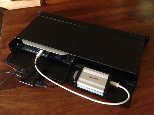

Another idea for a one space solution with zero noise is to get a (used) MacMini and to put it in a Sonnett RackMac Mini for example.
Like so: http://www.hitfoundry.com/issue_26/mac_mast.htm
Re: Xite upgrade idea for portable
Posted: Sun Aug 06, 2017 10:51 am
good one. i forgot about that.
