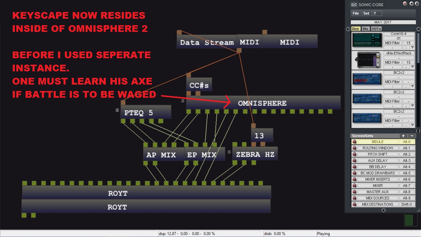

Posted: Sun Apr 23, 2017 9:06 am
Still going to build a Ryzen for general anti Intel purposes.
But forget about 8 cores, 6 will do.
I never get much time off and usually go from group to group, 3 x different bands I work with, learning new material, making sounds.
2 weeks off and I learned how to use Keyscape Creative and run it inside of Omnisphere, like Trillian.
Now I got plenty of overhead even in Dual Live Mode running multiple layers instruments/
PianoTeq and Keyscape are fantastic together.
Omnisphere 2 and Zebra 2 HZ are also Dogs That Hunt....
PROJECT WINDOIW.jpg (226.46 KiB) Viewed 10793 times
