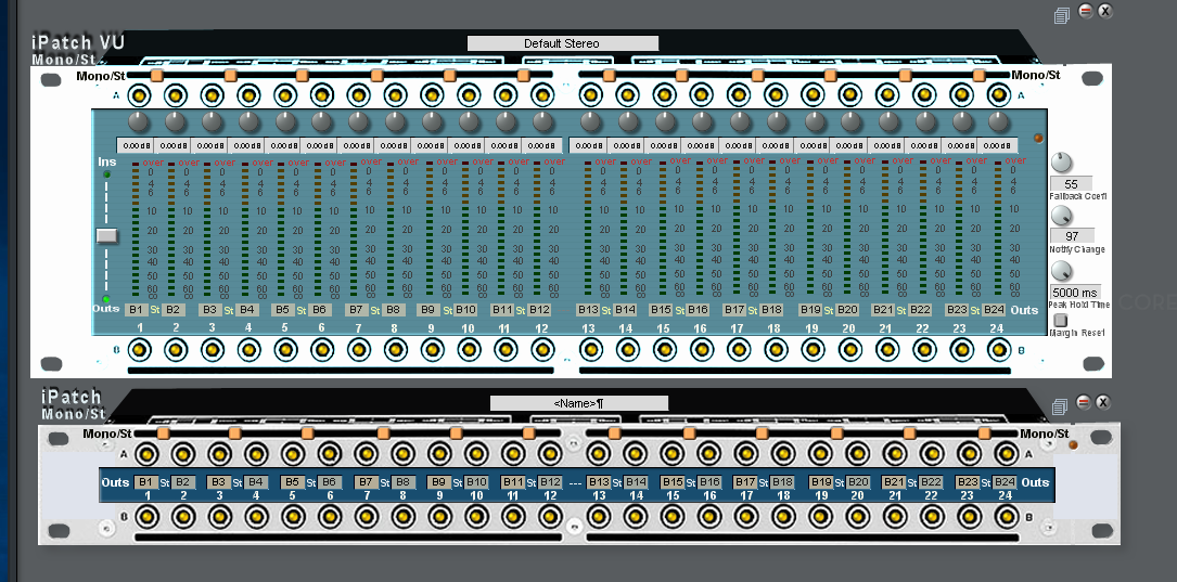

I have developed a couple of patchbays that you might find useful.
One is a straight forward 2424 jackfield and the second just adds VU's and trim pots to manage weak or hot input signals
The text faders allow porting of channels to any output channel
Main difference from a physical patch bay is you can port more than one input to each output
Stereo locks left and rights to work together
The yellow LEDs (centre of the input/output jacks) are mutes.
regards
maus

simple exterior
wicked amount of switching and logic required for a 24x24 matrix
Hope they are useful
maus

IPatch is exacly what I need, but why is it so DSP-hungry ?
Using the "VU-less" version, it costs 3 DSP-"bars".
If I would use 3 empty modular2 instead, this costs just 1 DSP-"bar".
Can it be optimised ?

nebelfuerst wrote: Mon Apr 13, 2020 12:02 pm IPatch is exacly what I need, but why is it so DSP-hungry ?
Hey there,
Yes I am was not that good at optimising when I built this.
When I get a moment I will check to see how difficult it might be to optimise,
regards
maus

I think, like many 3rd-party mixing devices and their buses/sends, these patchbays have, under the hood, all connections connected all the time. That makes these devices way more inefficient compared to stock CW/SC devices, which seem to dynamically make the connection as selected by the user.
What a joy it would be if someone could find out how to go about that and explain howto to fellow 3rd-party dev and SDK users.
