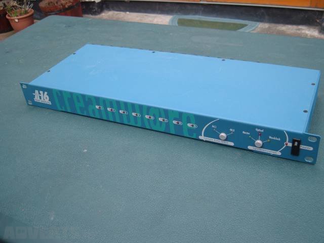

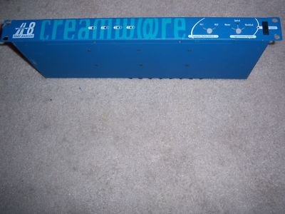

Are these the units you are talking about? (A8 and A16)
or do you have the A16 Ultra? or Blackface Sonic Core A16U or newer Ferrofish A16 Ultra MkII?

yes. these blue items are right beside of me.
