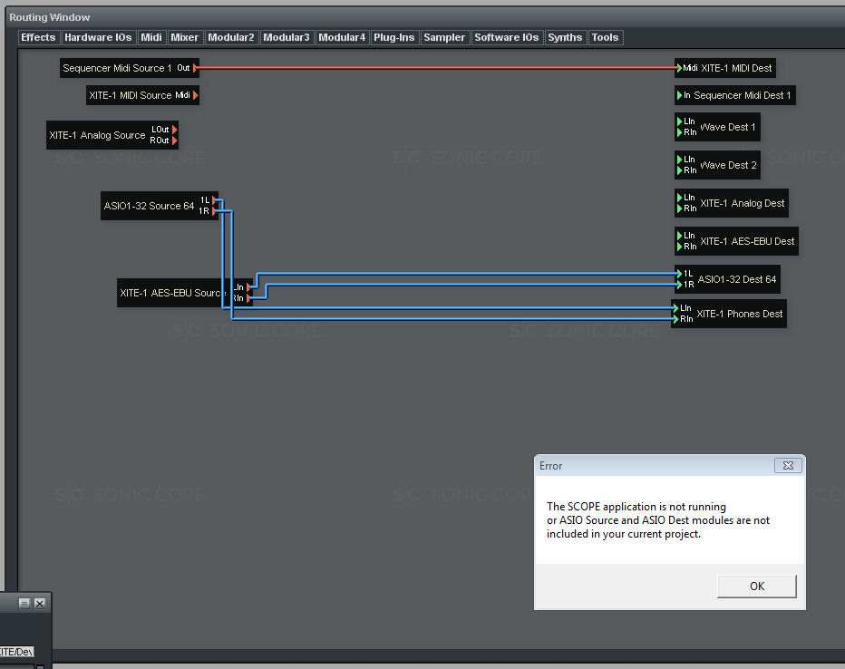

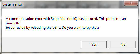

I can set xite-1 as asio audio device in ableton. I can see and hear audio on a track with source set to asio, but when I push the record button, audio and scope freezes. I have to reset Scope's dsp (message: communication lost) to get it running again.
I can record from other asio devices though. Anyone with the same experioence or any ideas, how to fix it? (S/R is 44.1k, original sound comes from AES/EBU, goes through STM 16. But direct connecting AES->ASIO doesn't work either).

garyb wrote:then there's most likely an issue with the setup. that's a very unusual behavior. many people use Live. no error messages, just Scope freezing? the rest of the computer still works, no cntrl-alt-del? irq?
Yes, only scope freezes. When I remove something, the error message (can't connect to board) appears. After restarting scope, it works again. And only when I push the record button. Until then, no problems.

what error message? please post a screenshot.
pressing the record button shouldn't affect Scope in any way. is there some kind of software monitoring on? perhaps a feedback loop?

Remove: a connecting between AES/EBU and ASIO out. I tried to use Adobe Audition, but this prgram doesn't even see Scope. I'll reboot and check the cables.
I tried the same with wave-out and found no problem.

Testing with odeus gives thios message. Hmm, something wrong with my project?
