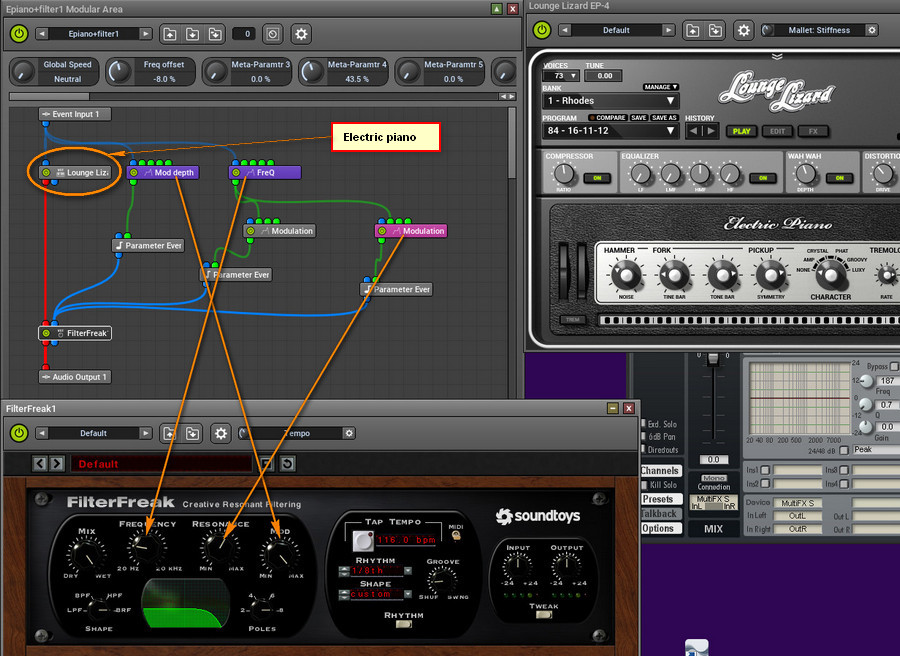

In the example here, on each notes the electric piano receives, it triggers 2 envelopes which are modulating the Soundtoy freakfilter1 modulation depth, its frequency and its resonance. The result is awesome ! And the modular environment allows to build amazing stuff.
