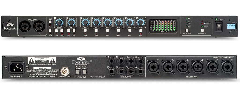

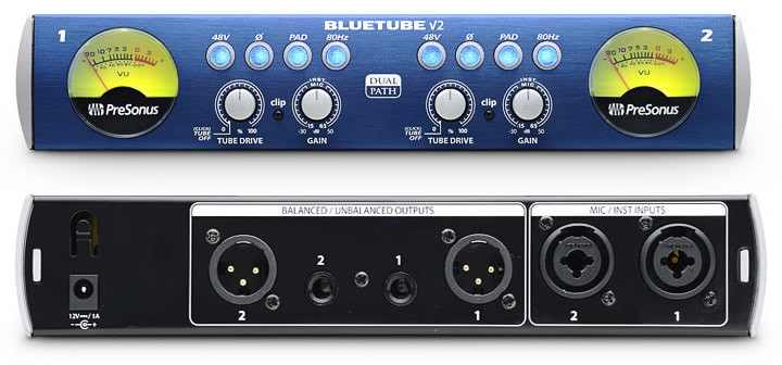

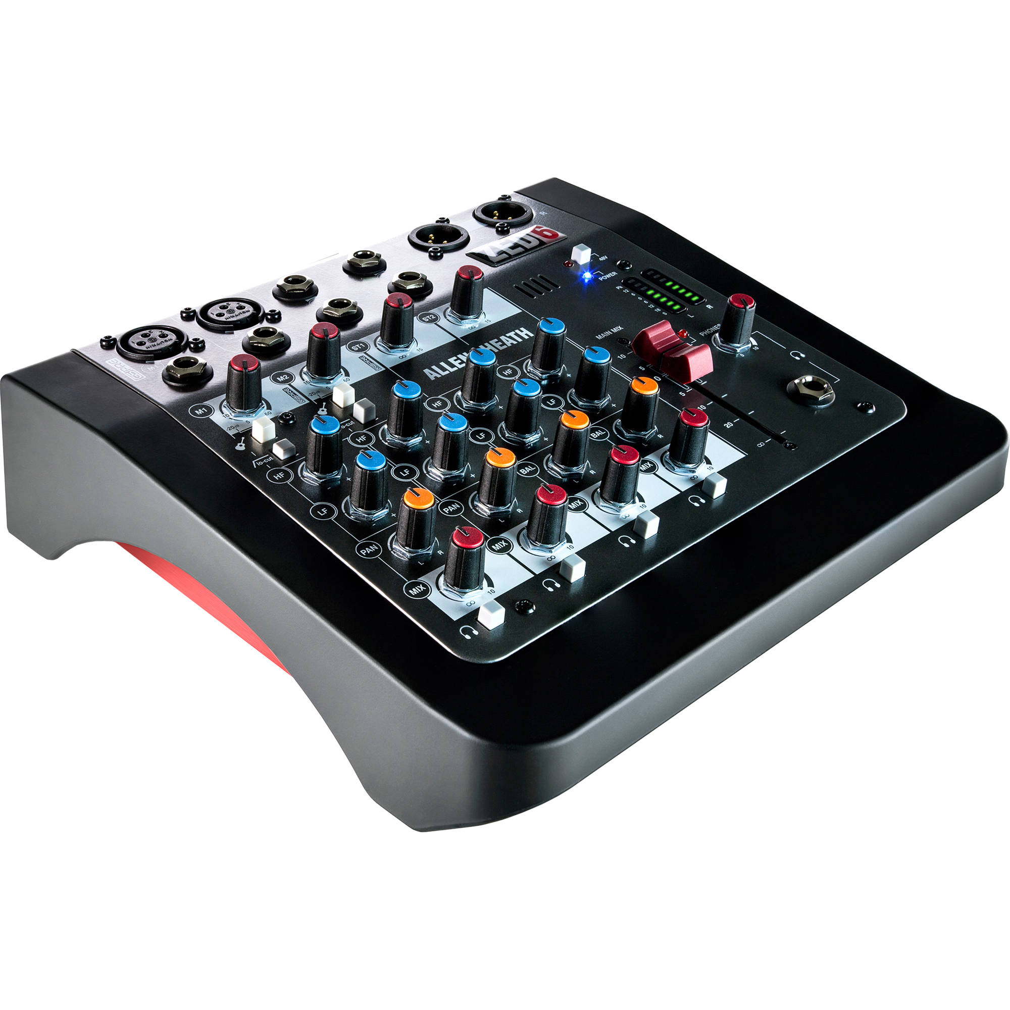

Was thinking I have three options
1. A small mixer feeding to the xlr inputs on the back of the xite. Maybe the zed6.
2. Some sort of tube pre amps feeding to the xlr inputs. Maybe the presonus bluetube dp v2.
3. Or expand via adat. Something like the octopre mk2.
The considerations are ease, flexibility, price and sound quality.
Option 1. Cheapest, various inputs so multiple things can be plugged in and routed to two inputs. (Audio quality could be questionable)
Option 2. More expensive, control over tonal quality. Audio quality is surely better than the mixer. Only two inputs so stuff is just temporarily plugged in when it's in use.
Option 3. Most inputs, high quality I would of thought. No tubes though. So just straight clean pre amps, but 8 channels of sound.
If I had enough cash I would just get option 2 & 3. Lol. But I got to make a choice.

- Octopre
- IMG_1321.JPG (60.68 KiB) Viewed 9860 times
- Bluetube
- IMG_1322.JPG (35.27 KiB) Viewed 9860 times
- Zed6
- IMG_1323.JPG (291.93 KiB) Viewed 9860 times

I use the Focusrite octopre dynamic MKII, it's ok but after 3 years of using, i think the sound is transparent enough but not "hot" enough for some usages.
I'd like to buy another converter to put some hardware effects into it, and i'm thinking about the ada8200.
