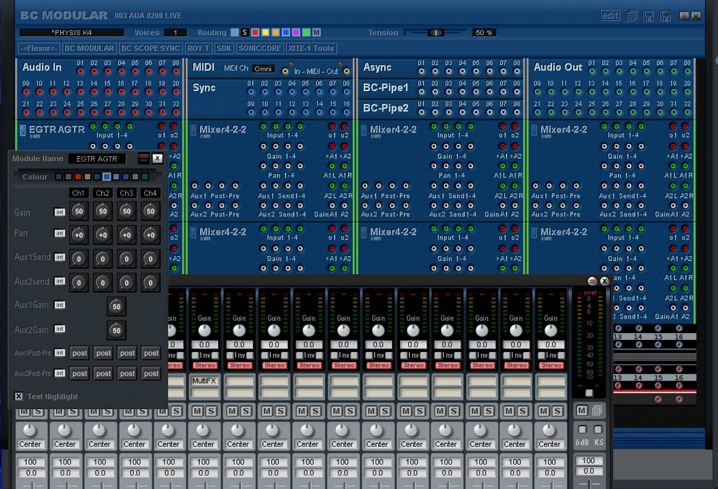

				Scope Mixers have Master + selected BUS on most mixers.
But hardware mixers usually have Master + 4 separate BUS buttons so complex monitor mixes can be made.
Without having to build a mixer with such flexible routing, could RoyT's modules shown below possibly do the trick..?
- 001.jpg (272.75 KiB) Viewed 8131 times

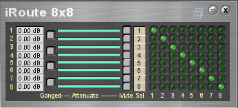

Is modular necessary for this?  What about this new device from Maus
- iRoute 8x8.PNG (37.08 KiB) Viewed 8092 times
There seems to be about a hundred ways to skin this cat just searching thru all the modular mix stuff and regular Scope mix stuff but I would use a matrix like this.

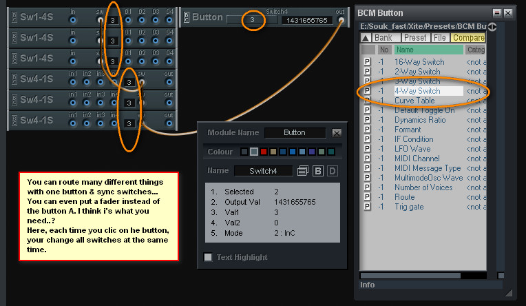

				You could also use the BCmodular switches : you may load as many switches you need, controled by only one button : the 'button A', with its preset, you can control 1 to as many you want switches. Sync switch accepts audio signal.
- Switch.jpg (108.08 KiB) Viewed 8068 times

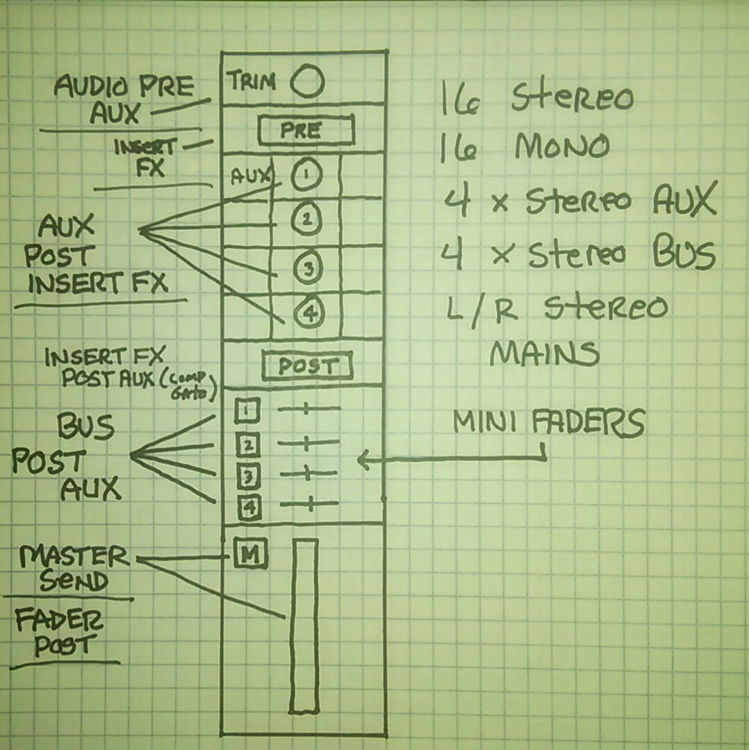

I need FX from AUXs bussed to IEMs and be able to send requested levels of each buss to the performer.

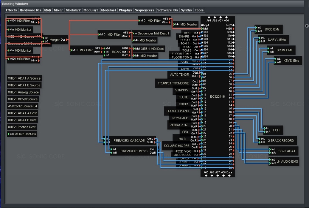

Here's what I need.
I got 1,000 bucks to the person who says no problem.
Half up front, 5 more when completed.
- _20161001_205420.JPG (216.75 KiB) Viewed 8060 times
				Re: Creating IEM Mixes In Modular
				Posted: Sun Oct 02, 2016 1:21 am
				by JoPo
				Now, I see why you have some difficulties... You want a gas factory ! To build this in modular is going to be hard ! There is no way to simplify like in SDK 'grouping' !
The big problem is to mix 16 stereo + 16 mono channels in modular with max 8 mono inputs mixer modules : you'll need to output some of them into others ! You gonna be completly lost amongst all those mixer modules !
I believe it would be easier to build this in the project window with bigger mixers than in modular... With Spacef modular mixer (which I don't use anymore & didn't update since years), you should achieve this easier...

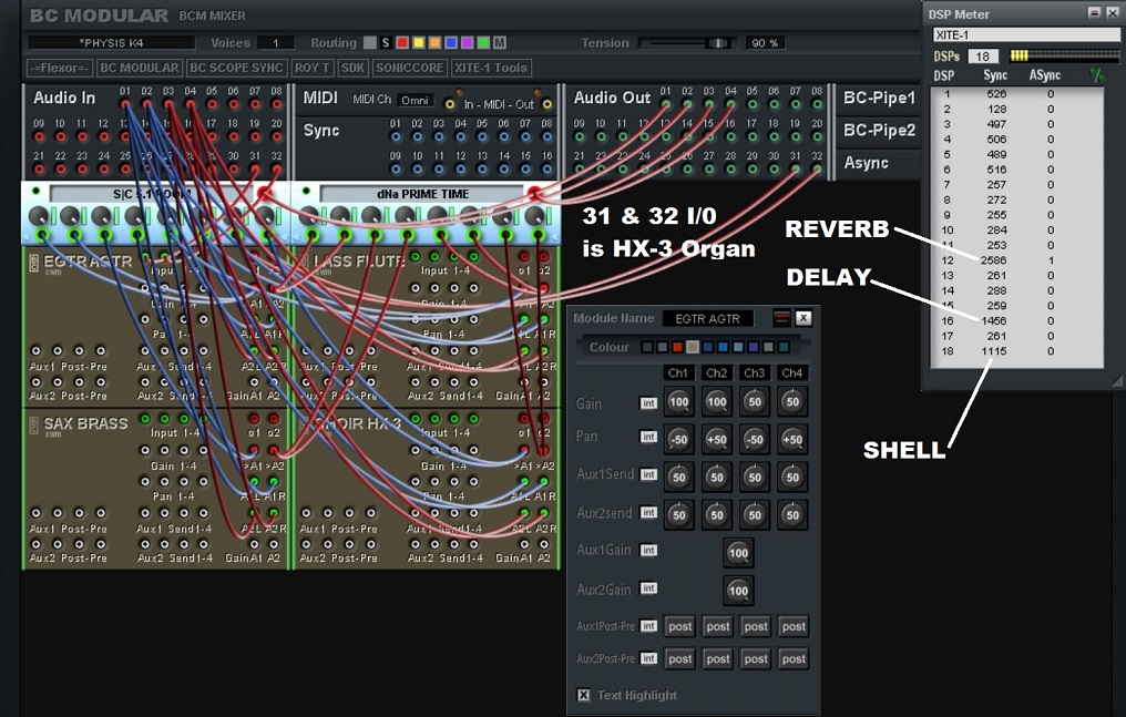

				Posted: Sun Oct 02, 2016 9:37 am
				So far 2 x TC Fireworx for vocals Cascaded.
I already automate these live and they're fantastic. Great sounding Reverbs, amongst other things like Ducking Reverse Delays, etc.
Another hardware TC Fireworx for keys.
Solaris and HX-3 Hammond Module.
2 x Vocal Mics with Eventide Harmonizer on background vocal mics, works great.
Bass Direct
2 x mic'd Guitar Amps
kick snare hihat, toms x 3 floor toms x 2
Stereo Keys from XITE-1
a pair of BLA Modded ADA 8200s.
				Posted: Sun Oct 02, 2016 9:50 am

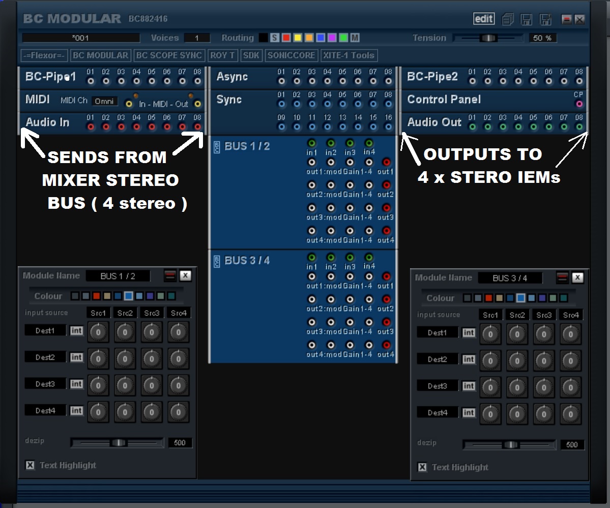

				I think this can work.
Might need Maus VU 8 x 8 in the project window, but things are looking good.
RoyT's dual AUX 4 x 4 x 2 Modulae was crucial.
As was DJ Micro's Mixer Shell.
Basically an ASIO/Drum mixer where Inserts per channel were needed.
I am Stocked, Modular is a bad mofo....STILL..!!
- 02.jpg (296.28 KiB) Viewed 8016 times
				Posted: Sun Oct 02, 2016 1:49 pm
				I can do it but need to speak to RoyT and see if a Module of 4 x 4 can be made.
The 2 x 2 works great and I can use other Matrix 8x8 modules for the busses.
I am stoked....
The icing on the cake will be SHARCS (not the ADSP 21369s) killer BCM surfaces to page through.
Never having to open the Shell and get freaked out by all of those cables and shit.
- 001.jpg (222.93 KiB) Viewed 7997 times

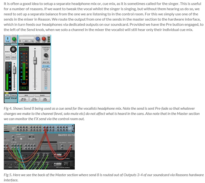

				Not sure how relevant this is
https://www.youtube.com/watch?v=stNSMhp ... P4&index=1 but the Reason SSL has 8 sends on every channel, so one should be able to intersect the mix of each send in the Reason Rack and reroute to ASIO and therefore Scope.
Haven't tried this myself, but using this it should be possible to create up to 8 entirely different mixes - if that's the intended end game here.

				I checked last night - the Reason SSL sends can be connected directly to the hardware outs (EG XITE ASIO) in the Reason Rack GUI - and from there to Scope ADAT outs and beyond.
So - one could use the first 4 SSL send busses for reverb, chorus, delay and flange for example, and the last 4 to create 4 independent stereo mixes outbound to h/ware.
- Reason SSL H/W Interface
- reason_ssl.jpg (169.3 KiB) Viewed 7939 times
