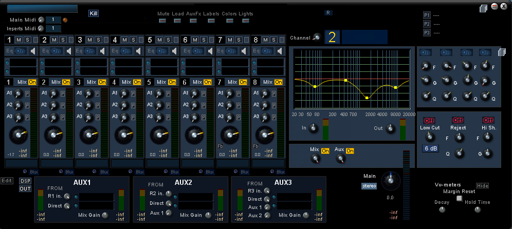

I tried years ago. Took me many attempts, changes and re-do.
At the end it works...as long as you don't assign midi CC to the Eqs. then it becomes unreliable.
May be the technic was not the right one...
Pic of an un-released experimental device.
- MIXER-S8-EQ.jpg (304.77 KiB) Viewed 28422 times
