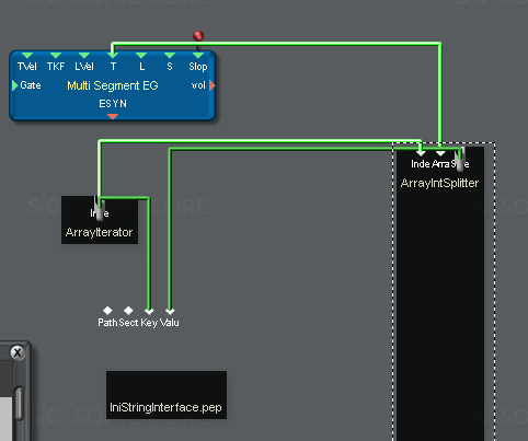

Netx question: how can I connect the value with the EG? Does is EG (1 for each partial) need a new new pad to connect to the value? Does such EG exist or do I need to create my own EG? I would like to use the Multi Segment EG, which has T L S entries, but I can't connect them to the Interface.

I'm a little step farther now: I can read/write array elements from/to file, but I haven't find a way to iterate the index in the ArrayIterator. I can do this manually and get the actual data, but I want to use something, which does this for each index (incl. read/write). Any ideas, how to accomplish that?
Or is there a function, which converts arrays to string (CSV) and vice versa?
