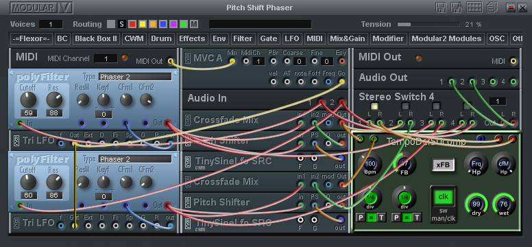

				Phasers are my favorite effect.  Always striving to attain that ultimate 70's swirl.  Tried all of the modular phasers and I think I like the stock PolyFilter the best........for now
- Pitch Shift Phaser Pic.PNG (174.79 KiB) Viewed 7492 times

				Very good idea to blend phaser & pitchshifter into a delay !
Gonna try this right away...

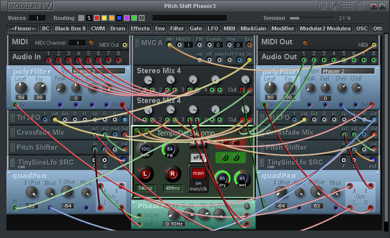

				Added some panning and modified it a bit to include internal mixers on an 8 input mod shell
- Pitch Shift Phaser3 Pic.PNG (244.11 KiB) Viewed 7300 times
Soundbite performed with stock Profit 5 and CP300 strings
