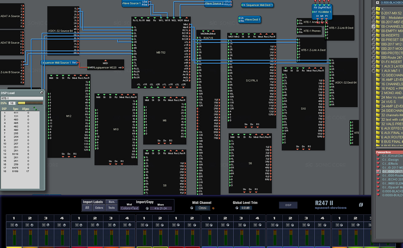

That's my default project modular mixer setup under xite-1 / win 7 pro 64 bits, for quite a while now, a few years I think.
I am using it without a problem with studio one v3, and various external sources (synths, mic, guitar , bass etc).
I have several gates, Vincos, Eqs etc in the channels in the default project. I can add modulators, synths etc if needed, but i confess i under-use the xite in favour of vstis and hardware synths these days, eventhough I would not change it (xite/mod mixer) for anything else for direct inputs of synths, guitars, mics etc. it works perfect for live too (i am just rehearsing stuff for fun, hoping that i will be able to bring my whole setup on a scene in a few month, which is just a matter of working a few tracks, and finding a couple of other musicians (and a big car or a truck because my setup begins to be heavy and big ;-)
(pic is 80% of real size).

Re: SpaceF Modular Mixer in 2016 (anyone using it with XITE1
Cool the way DSP 18 gets maxed out.
I find that leaves room for everything else after the last 4 are packed.
spacef
Posts: 3356
Post by spacef »
dawman wrote:Cool the way DSP 18 gets maxed out.
Yes, dsp 18 is fully used, then the dsp 17 is less than 15%, and the few first ones are around 30 / 40%.
I can still load many stuff.
Also, I don't use DSP allocation, I let Scope do its thing by itself, it works just fine that way.

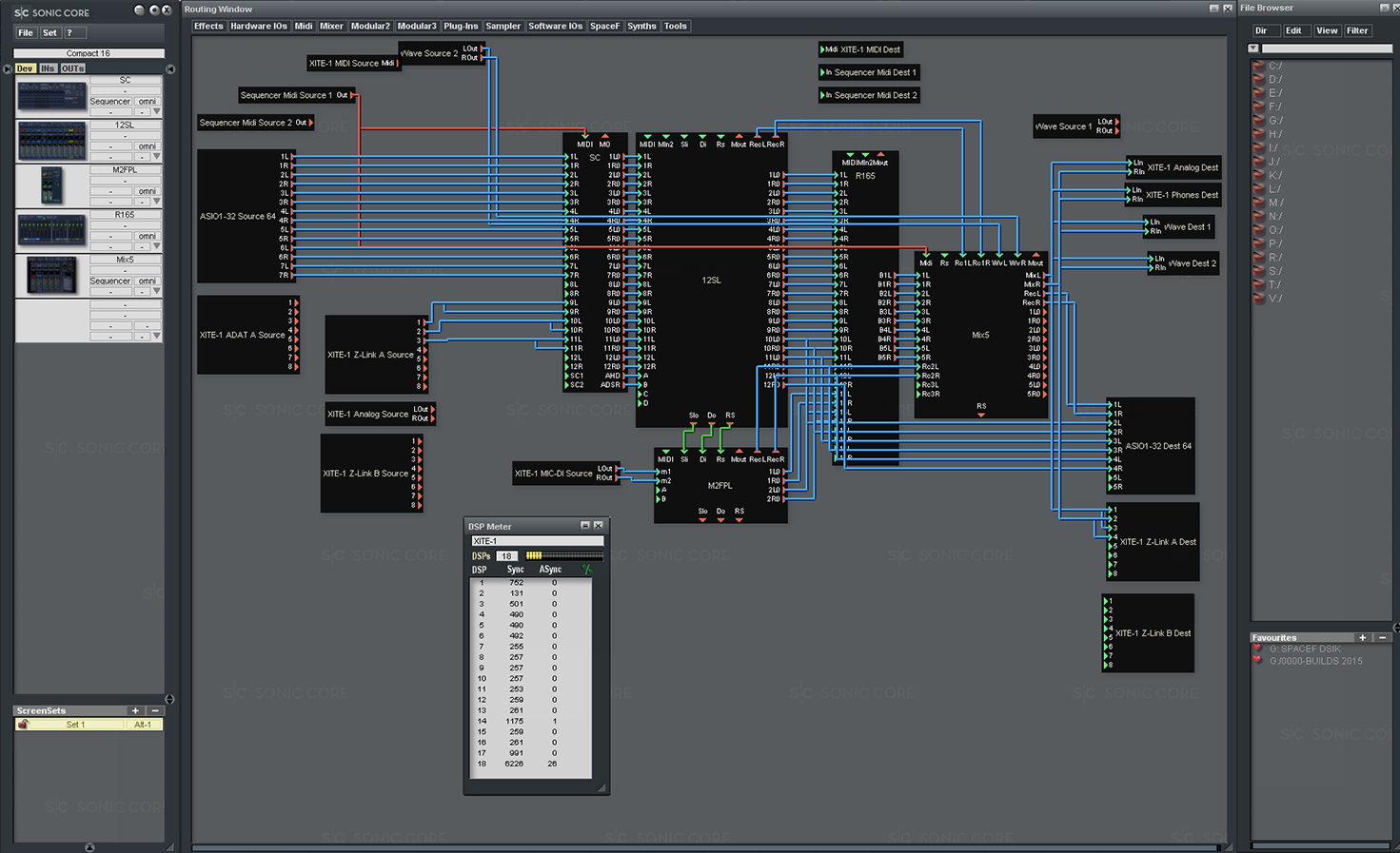

There is something to know when this DSP is packed, because you might think that Xite won't let you add any connection.
In fact it is possible, but needs a little bit of project-rebuilding.
You may get messages like "no more connections from DSP x to DSP Y (or DSP "d"). In fact that's how you can add many connections:
- First make a backup copy of your working project, just in case.
- then you need to remove a couple of modules from the project: check on the DSP meter that the dsp that was full is now less full.
- save that project. I save it as a default project, so it loads imme di ately on scope restart, and dsp allocation is not "polluted" by a previous project.
- Exit the Scope application, then re-start it : that's how you really "flush" xite's "memory of connections" that are still there even if DSPs look half used (meaning even with a less full dsp, you can't add connections until you have exitted and restarted scope app.
- Now, once the project is restarted, load again the modules that you need (the ones that you removed), and connect them as usual: it should work without problem. And add the connections that you couldn't add: now you can.
- Save your new project with the additional connections,
- re-exit scope, and restart it: the new project should load fine (and Xite will put all the connections on the last DSP(s) ) .
That's something I posted somewhere on Z already, but worth posting again, as I needed to add 4 connections to ADATs, and Xite won't let me, while I had no problems adding devices and effects here and there. I even used ligheter devices, but it did not work. That's how I remembered that scope in xite keeps a trace of the connections, and has to be "flushed" by closing the app and restarting it.
So try to remember that trick: when Xite says that it has no more connections availale between 2 DSPs, the solution is most of the time to remove a few modules/devices to free like 25%-30% of that DSP. Then save, then restart, and add modules and do connections only when scope app is restarted, because at this moment it is still "dynamic" and the application did not yet allocate all the connections of the modular mixer to the DSP 18.
With that trick, you can add a lot of connections to a project that said you could not a few minutes ago.
Generally, it's enough to remove 1 router/stem. but it depends on each project. You will quickly find out though. You can always make tries to see which individual module frees the most of DSP 18, and save a preset of that module to be recalled later on, then apply the full procedure above-described.
And remember, the important thing is to exit and restart scope to flush its "memory of connections between dsps", otherwise, it won't let you go anywhere.... Myself, at some point I even switched thee Xite rack off and restarted the PC, but I am not sure it is necessary. Exiting and restarting scope with less modules on that DSP 18 is the real trick.
Happy modular mixing :-)

The next version of the router will uses approximately 1300/1400 cycles less than the current version. That's for the 24 channel 7 stereo bus version with all connections and dsps activated. Internal connection can also be disconnected by groups of 4 in case it is needed (not the case in current version which only has dsp management, not internal connections) + you can lower the number of active channels too (I will still do the various versions anyways - if I survive this project until it's done :-p ).
It's not really the dsp usage that can be problematic, it's more about the number of connections available between dsps that can is annoying, but there are workaround as explained a few posts above...

Is all that valid for XITE-1 and devices (stock & 3rd party) in general or just only for usage w/ the SpaceF Modular Mixer(s) ?
it's an Xite thing (for the moment at least) but it is more likely to happen often with things that require a lot of connections between modules over several dsps, such as the Modular Mixer. As a general rule, all Mixers involves a very high number of connections, especially internally, and eat up this ressource more quickly than, for ex, a synthesizer whith high polyphony (there are not a lot of connections inside a synth, or at least, the number is not comparable with what's inside a mixer). So the game on a mixer is either to make the internal connections dynamic (ie activate channels at user request, and after a while you don't have connections anymore, but you have advanced in your project more quickly) or to spread smaller modules over several dsps, resulting in less connections from a dsp to another, which brings the possibility to never run into connections limits, or at least, much later in the project -- but in that case, it is the users who want to use a classic mixer looking device (all in one device). There are other tricks such as bringing features without connections (such as in most SpaceF Mixers, where the solo sections has very few connections contrary to a more classic solo section which is in fact like another mixer inside the mixer (mixer for solo + mixer for "not solo" and you switch between both when you engage a solo button, or "kill" the solo... don't talk to me about "kill mute", it won't happen before long because of this :-) ). On Modular Mixer, it is the large stems and routers which involve a high number of internal connections, especially the "stems" modules which are Routers with channels and other features. I'm working on that as we speak (new routers).
I can't answer for the rest. It is possibly a limitation by analog devices themselves rather than xite. I don't know.
