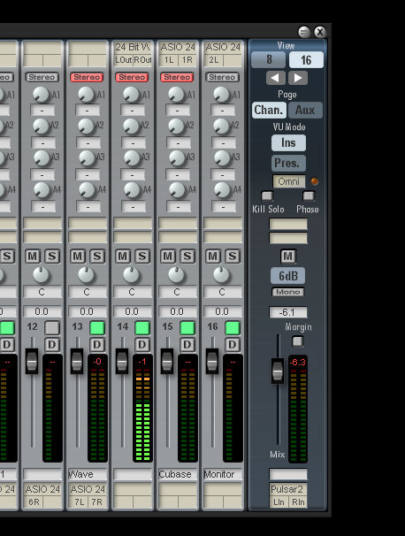

So, I have signal in the 14 channel but signal wont go to the master channel?

Just one Pulsar card. I don't have error messages. Everything looks normal, but sound wont go to the master channel. All others channels work normal.

this is pic

14 channel wont work... And the others ? 8)
Is the green "mix" button on, on each channels ? Did you try another mixer ? Delete it and reload it ? Do you get sound at the direct outputs ?

JoPo wrote:14 channel wont work... And the others ? 8)
I have sound on direct output.
which mixer you recomend. I need 16 chanels with direct outs and 1 aux.

I have strange behavior here.
So, When I reload mixer and just set 14. channel to STEREO then I have sound from that 14. channel on master channel.
But when I set 13. channel to STEREO, then 14. channel wont go to mix.
then I set back 13. channel to MONO but 14. channel stil wont work properly.

I did whole unistalation includeing drivers, then I did new instalation but didn't help.
If the only 14. channel is stereo then works ok, but when I set 13. channel to stereo than 14. channel wont route to mix.
... and I can't force 14. channel to work properly anymore, even if I set back 13. channel to mono.

I did startup project useing STM 1632 but I leave 13. channel mono, and then 14. channel working well.
