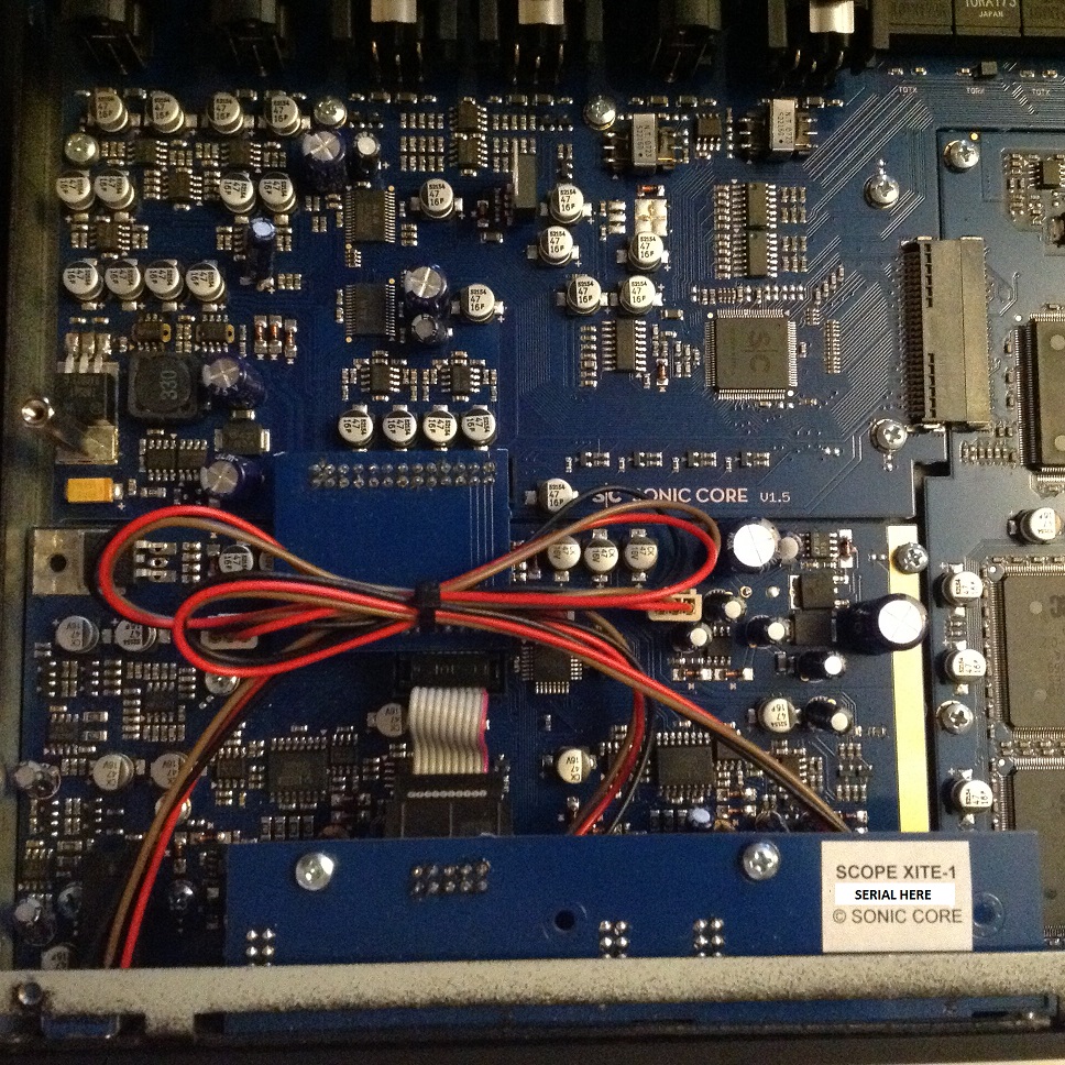

So I uncrewed all relevant screws and carefully took off the top panel and checked inside the box to make sure no loose connections. Disconnected and reconnected the ribbon cable from front panel PCB and did same to the 3 white connecters either side of that area, to make sure they are seated properly.
Tried turning on again and the front panel I/O worked. So I put top back on and front panel I/O stopped working. Tried this a couple of times, but sometimes it doesnt work even when I removed the top panel and sometimes it does. It is very intermittent, so to me it looks like either a cold solder joint somewhere, or a component is playing silly buggers. Only other thing could be a dry joint on the HDMI connection, possibly?
Any other suggestions will be more than welcome, but at this stage I think I might have to send back to SC for repairs and to see if they can find out where this bleedin intermittent fauilt is.

				- XITE-1 Left Side PCB showing Front Panel PCB .jpg (498.96 KiB) Viewed 7617 times

Ok, been at this for a few more hours now. The front panel I/O's seem to prefer to work when I remove the top of the unit. Not always but most of the time. But when I put the top panel back on again and restart, the front panel I/O nearly always stop working. Sometimes a tap will get it working but mostly no good.
So after several times taking the top off and putting it back on and restarting, I finally got the top panel back on and the front panel I/O working. Only then did I try and screw the unit back together and everything was working fine. All screws back in, and the XITE-1 working fine. So did a shutdown and turn off then a few mins later a restart, but once again the front panel I/O's are no longer working. I am sure if I restart a few times eventually they will start. But this is crazy. Does anyone have any idea what this could be, such as a dry solder joint or something like that. Or perhaps a bad cap somewhere that doesnt seem to charge on starting up. I think I need to return this for repair otherwise.

DragonSF, yes I am beginning to think it can only be a cold solder joint as you too suggest. Thinking about the fact that the front panel works nearly always when I remove the top panel off the unit but as soon as I put it back on the front panel I/O may or may not work, one thing I have noticed is when the top panel is on, if I look from the bottom of the XITE-1, the top panel seems to push the front plate of the XITE-1 slightly on each side, which creates a very slight bend in the front panel. I am beginning to think this could be affecting a contact somethwhere on the front panel, and looks llike a slight fault in the manufacturing process of the panels.

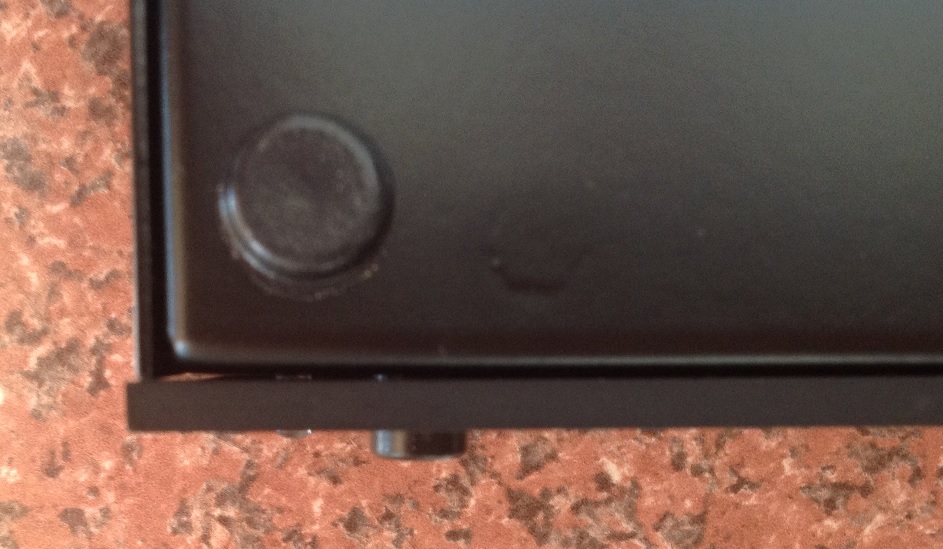

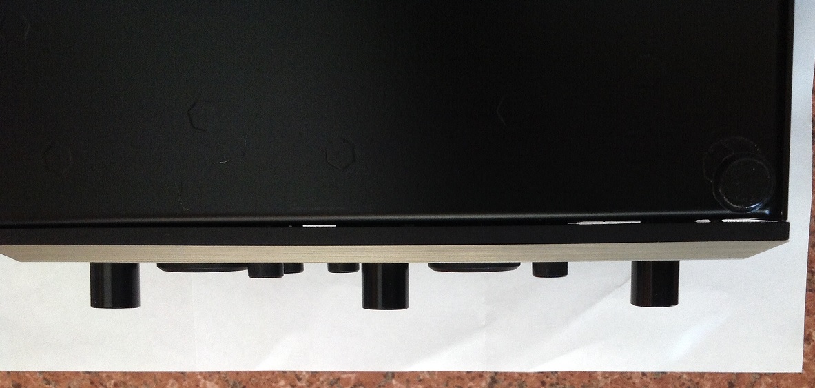

As you can see from the photos, the front panel is being pushed out at each side by the top panel of the XITE which folds over the sides and back of the unit when in place, so I think this may be part of the problem, and perhaps the only thing I can do now is to contact support and see if I can get the unit returned for repairs. A real pain, but I guess there is little else I can do at this point. However I am open to any other suggestions.

Yes, I think it has to be a dry solder joint somewhere, either on front panel PCB or the connectors to main PCB. My theory is that when I take the top panel off this allows a tiny loose solder to spring back into contact with the component or trace, but when I put the top panel on again, it is causing a hairline solder crack to sometimes move out of contact. This happens or doesn't happen on startup, it's quite random, so not a cold or heating up issue exactly, but related to a contact issue somewhere. I will investigate a little more when I have time and if I can't sort it myself I will send to SC for repairs. But thanks for the help and cheers for now
