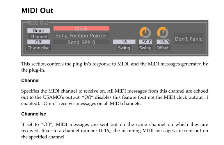

In fact, by reading the usamo plugin manual, I can read :
So, it seems usamo can send incoming midi messages on the same channel number it is on the daw track or it can be sent out on a the specified channel.
Of course, I'll be absolutely sure only when I'll try it but apparently, you're wrong, Shogun... I hope you(re wrong.. :D

Shogun, the link you provided seems to confirm 16 channels ! See last post of "os" on that page : https://www.muffwiggler.com/forum/viewt ... &start=375
Yep, JK, latest ScopeSync allows several control over 1 audio signal but those control are audio like data : in cubase, it's automation control, you must draw it in the tracks window, not in midi editor and, don't know why, it crashes cubase. The benefit of usamo is (I hope !) to have as good midi timing as with vsti : sample accuracy... Yummy-yummy ! :D

Ah, yes, I was forgetting ! The usamo uses 16 midi channel, no doubt ! :wink:
