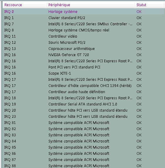

I went to check if I could disable some USB's. But Xite doesn't share any irq with any usb. I disabled several usb's and kept only usb's I must keep. That didn't change nothing on the Xite irq : they are exactly the same :
And I find Xite share its irq (IRQ 16) with a lot of things, like the graphic card ! But there is no way to change that ! So disabling usb's, in my case, seems to have no effect. I'll check, anyway, if there is benefit but I'm affraid it will change nothing.

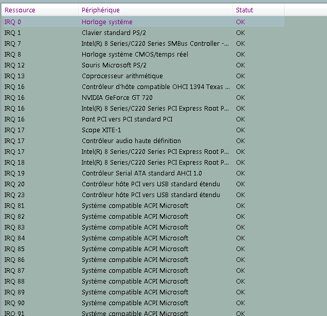

Yes ! That's exactly what I just did : I exchange my 2 pcie cards : Xite & firewire controler for my powercore.
I hope the powercore will still work a well as it was.. And now, I need a lot of time to be sure it's better.

I didn't had to wait that much ! Scope crashed after saving 3 mn after loading a project ! All I did : disabling 75% of usb's + changing Xite pcie card slot are useless !
So... It's not usb's, pcie bus doesn't change nothing and Xite irq had changed after moving it in another pcie slot. Then... What ? Why is there so people here who never have that kind of issue and other, like me, who have it ??

of course the IRQ changed after moving slots! that's how it works.
