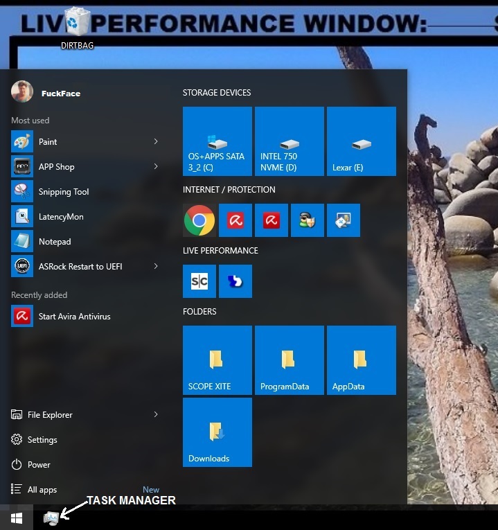

Re: Avira Antivirus + Spybot Search & Destroy
Got the perfect workflow in Windows 10 now.
Can simply disable real time scanning in all Anti Virus software from the Start Up Window.
No more cluttered screen except for Recycle Bin (DirtBag).
