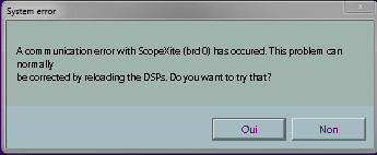

Hi..
I don't remember I already had that message with my Xite-1 :
comm error.jpg (13.31 KiB) Viewed 3567 times
After choosing "yes" the dsp's are reloaded but it happend again after.
I checked the HDMI cable, the pcie card, restarted the computer...etc...

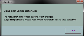

One time I choose "no" and get 2 more messages :
comm error_2.jpg (9.78 KiB) Viewed 3567 times
And after "ok", that one :
comm error_3.jpg (11.9 KiB) Viewed 3567 times
What the f...k ?? :o Any idea ?? HELP !!

I think it is related to the HDMI cable.
If you see the message.
Quite the xite software, shut down the pc,
reconnect the hdmi cable and restart.
In general the connection with the pc is sensitive so you shouldn't put strain on the cable, move it etc.

Well... I already did all what you say...
I'm going to make some test to try to find what's going on...

Very strange ! Several seconds before it occurs, the STM meters freez ! But only the STM ones !! Not the other ! :-?
Re: Disturbing communication message
Posted: Mon Feb 01, 2016 9:11 am
by JoPo
So... Apparently, as incredible as it seems, it's the Scope project that is corrupted... I played the Cubase file with another Scope file without any trouble.
Now, I must find which part of the Scope project is guilty... :oops:

I've been facing similar issues and would have periods of time with no errors and then others with this happening repeatedly..
As per Gary B I have replaced my HDMI cable and haven't seen it since..

Yes.. I've seen your thread.. But I'm quiet sure it's not the same problem : it works perfectly with another Scope file. I believe I'm about to find what happens, I'll write it here .... soon (I hope !)....

So... Apparently, it's much less serious than I thought...
I deleted an DAS comp AI with a filter at its sidechain input and the problem seems to have disapeared... It was really weird, it's not the first time I use the DAS comp with filter in its sidechain input. I replaced it with a sidechained limiter and I find the result better ! :P
I just hope it was that..........
