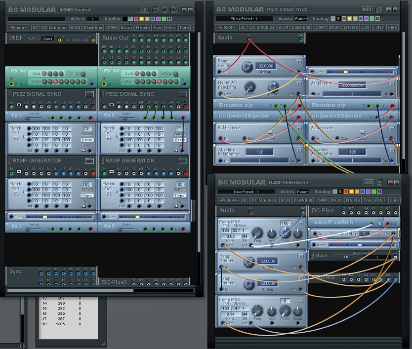

				This is the control part of the sequencer I am (trying) to build.
- BCMFS Control.png (606.05 KiB) Viewed 12246 times
The signals from the PS32 go through the PS32 SIGNAL SYNC module where I delay the signal untill the end of the ramp.  You can control the range of the PS32 there also. In the modular I attached the right side only responds to bank changes on the PS32 module. So only patterns 1,2,3,4.
The RAMP module has some ramps for timing. Also mixed through a matrix to give loads of options combined with the pattern matrix.
I'm sure it can be improved so I am looking for feedback!
