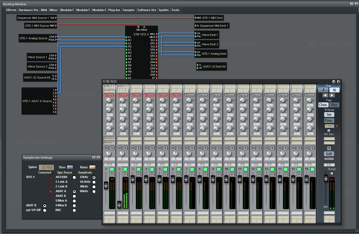

plan a:
1.) load+ "XITE-1 ADAT destination" to load driver or so
2.) XITE Master must send ADAT-Out Signal (see red light) to A16 ADAT-IN (master clock send to slave)
3.) now you can connect audio
plan b:
Better, connect over wordclock
!! ftp://sonic-core.net/../software/scope5 ... k-XITE.zip
example: 4 rechner-system in sync

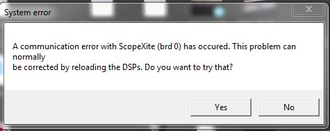

The strange thing is that everything else in the xite is fine, apart from this message when I launch scope
scope error.JPG (23.08 KiB) Viewed 4481 times
but I can change sample rate, all other inputs work with no problem.
are there any Bios settings that would interfere with scope/xite hardware?

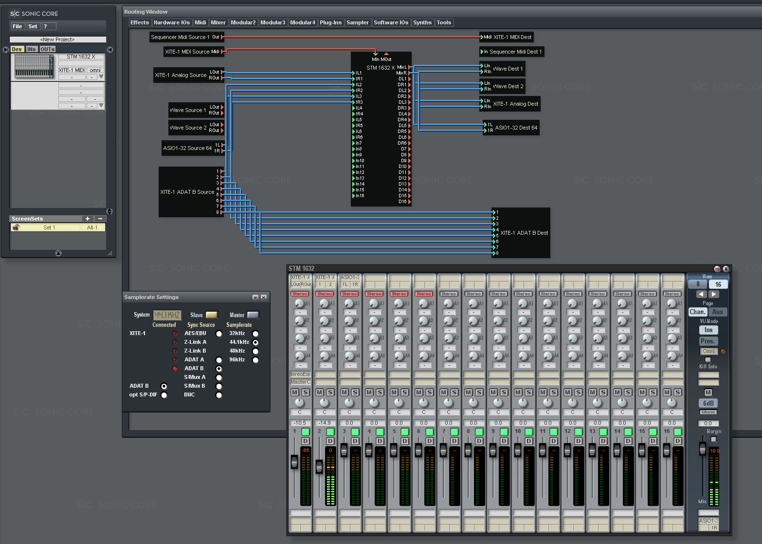

1.) who is master
2.) who is slave
3.) A16 switches back/ front, what say manual
4.) xite project: ADAT source/Dest A and B
plan a:
A16 (master) ADAT A or B out > xite ADAT same in (red LED select then switch to slave)
plan b:
xite (master) ADAT A or B out > A16 ADAT same in (select + slave)
brainstorm: ADAT is 8 channel protocol, A16/Xite have 2x ADAT-protocol, you must correct define
hope your night will end in happiness :wink:

I just tested the xite adat a & B ports connected to my PCI scope system
no issues adat is working fine on the xite.
I connected the ferrofish to the PCI scope system and fed the mixer output to the xite on adat b
and everything works great the xite will work as slave with no issues.
but for some unknown reason the xite will not connect to the ferrofish directly on either port?
anyway I have a workaround untill I can figure this out

Ambient Source wrote:The strange thing is that everything else in the xite is fine, apart from this message when I launch scope
Did you install the XITE-1D hotfix and do Garyb's cset.ini hack ?
http://www.hitfoundry.com/issue_09/xit_mast.htm - XITE-1D Installation & Tips
DOH !! :P
Re: Xite 1D /ferrofish A16 adat weirdness
what dante said.....
if it works with the Scope card and XITE, then the XITE is 100% ok....
