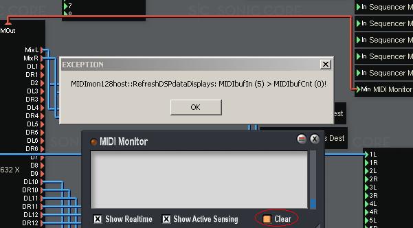

Midi-Monitor
error-message when press "clear" :evil:
OK, you can live with this~~

I get this too, have been for a long time.(Scope 5.1 Win7 64bit and Scope 5.0 Win 8.1 32bit) Happens at random intervals when clicking on the clear button. Small annoyance yes but not a showstopper.
Thought it might be due to active sensing but I have my midi routed through a midi filter and into the midi monitor
hubird - any tips on how to get rid of it since you don't seem to get it? What are you doing different?
What version of Scope are you on?
What OS?
@Spielraum: This might be something common to both of our setups and not Scope's fault at all. My main keyboard sends out the nasty active sensing data that cannot be turned off so I use the Scope midi filter but there might be something else involved. Are you using Copperlan?

well that's really strange then. The fact that it's happening on 2 different machines with both 32bit PCI and 64bit Xite makes me want to think it's either my keyboard or my Midex8 or Copperlan.
Oh well, click to close the popup and move on....
since scope 5.0 x86
up to scope 4 was no error... on same system
Midi_Monitor-ERROR_but_NO_Crash (WinXP_SP3_x86-XITE1_Scope5_1).JPG (38.51 KiB) Viewed 4746 times

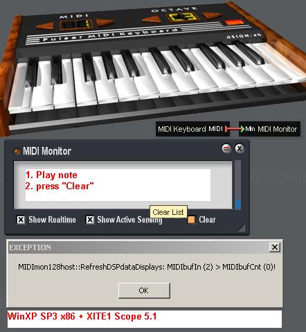

Re: BUG Midi-Monitor
v5.1, perfect here.
Spielraum
Posts: 806
Location: Raumschiff Erde
Post by Spielraum »
garyb wrote:v5.1, perfect here.
WinXP_SP3_x86-PCIpulsar_Scope5_1
also perfect

please note
XITE1: :evil:
PCIpulsar: :)

same error on
Win7 x64+xite1+scope5.1
roy thinnes

fresh project and only the midimonitor,
just the same ~ try and error...
but only with xite...

Don't bother about this. It's "normal" and no serious.
Its an overflow on the buffer.
Always wanted a large MIDI Monitor for Scope that expanded to page size.
Just clearing the buffer an extra time works for me.
Would love to see a drag down capability though since I use one on every input and output of the project.
