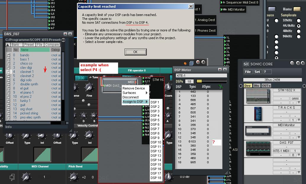

had to buy the nice f07 for xite, but xite crashed DSP when load preset :(
anyone help?
(connect only on DSP2 is to small for this fat dev)

Re: XITE1+Scope5.1+das-f07 // DSP HOT BUG
any error messages?
can you provide a screenshot?
BUG_F07 (DSP-Error) (WinXP_SP3-XITE1_Scope5.1-2015_09_24).JPG (125.11 KiB) Viewed 3461 times

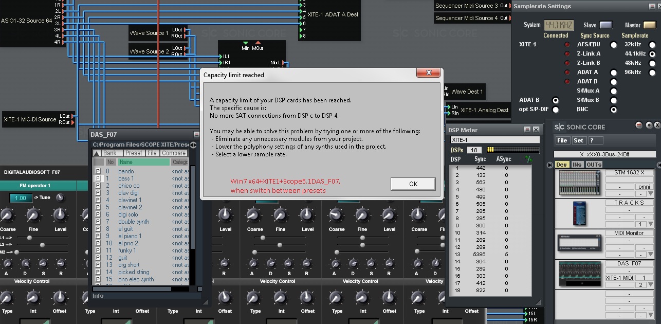

BUG_F07 (DSP-Error) (Win7_x64-XITE1_Scope5.1-2015_09_24).jpg (263.09 KiB) Viewed 3461 times
it's not a bug. it's that you need to assign dsps for that device. all the connections between dsps are already used in the configuration you are running. moving that device or another device to another dsp would fix the problem. try reducing polyphony to get everything to fit, then move the dsp load around a bit.
everything has a limit.

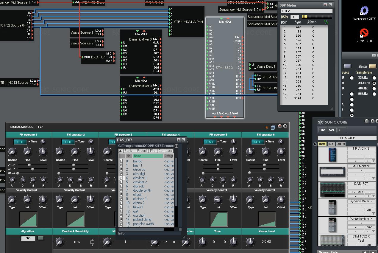

after delete mixer "STM1632"
the DSP-power auto-link main part from DSP-c to DSP-h,
and now, no more crash...
also without manual DSP-connection or Voice-limiting
conclusion > from bug to benchmark
or "STM1632" is XITE-bugi
:roll:
edit: after delete reload mixer before benchmark-test
F07-Benchmark (WinXP_SP3_x86-XITE1_Scope5_1).JPG (192.21 KiB) Viewed 3409 times
no, you're supposed to get that message when you use all the sat connections between dsps.
try moving the synth to another dsp. i believe there is a map here of the dsps and their connections. perhaps someone can point you to it.
there are different types of resources and all of them have limits. if all voices of the synth are on one chip, it's all good, but if you raise polyphony and then the load gets split up by two or more chips, then the limited number of connections between chips comes into play, especially if there is a mixer taking up the same real estate. there's no mixer bug.
just put the synth on one of the almost unused dsps on the other end of the board. it's all about how the load gets distributed. there is an algorithm for how things are loaded, but there's no way for the engineers to compensate for every possible order that every possible mix of devices users might load. yes, the order that things are loaded in matters, as far as what resources are available. you can shuffle dsp assignments by right clicking on a device and following the prompts. normally, you wouldn't need to mess with the automatic assignment, but sometimes it can be helpful.
it's possible that other mixers may handle resources more efficiently or in a different manner and might not even have this conflict, but that's not because of a bug. this is the first time ever that i've seen this complaint, but i don't think it's that surprising.

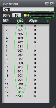

In DSP meter window, click %,- it shows how much SAT connections are in use in percent.
The graph-bar showing DSP load on XITE-1 has nothing to do with SAT connections (communication lanes w/ old DSPs and computer).
Depending on device, you might run out of SAT connections far before you load more on XITE-1.
In theory, you can load over 90% on XITE-1 DSPs but in real world and because running out of SAT connections, it´s approx. 60-70% in most cases (projects).
You have something creating very high "sync" value on DSP#18.
Move that device to DSPs #7, 8, 9 or 10 because these are the top DSPs in each of the 4 DSP slots (array of 3 DSPs).
Try finding one of these showing lowest load in % !
DSP #18 is the last one in slot 4, o.k. for any device not needing more than 1 DSP, bad for others spreading their load across several DSPs (in a slot).
