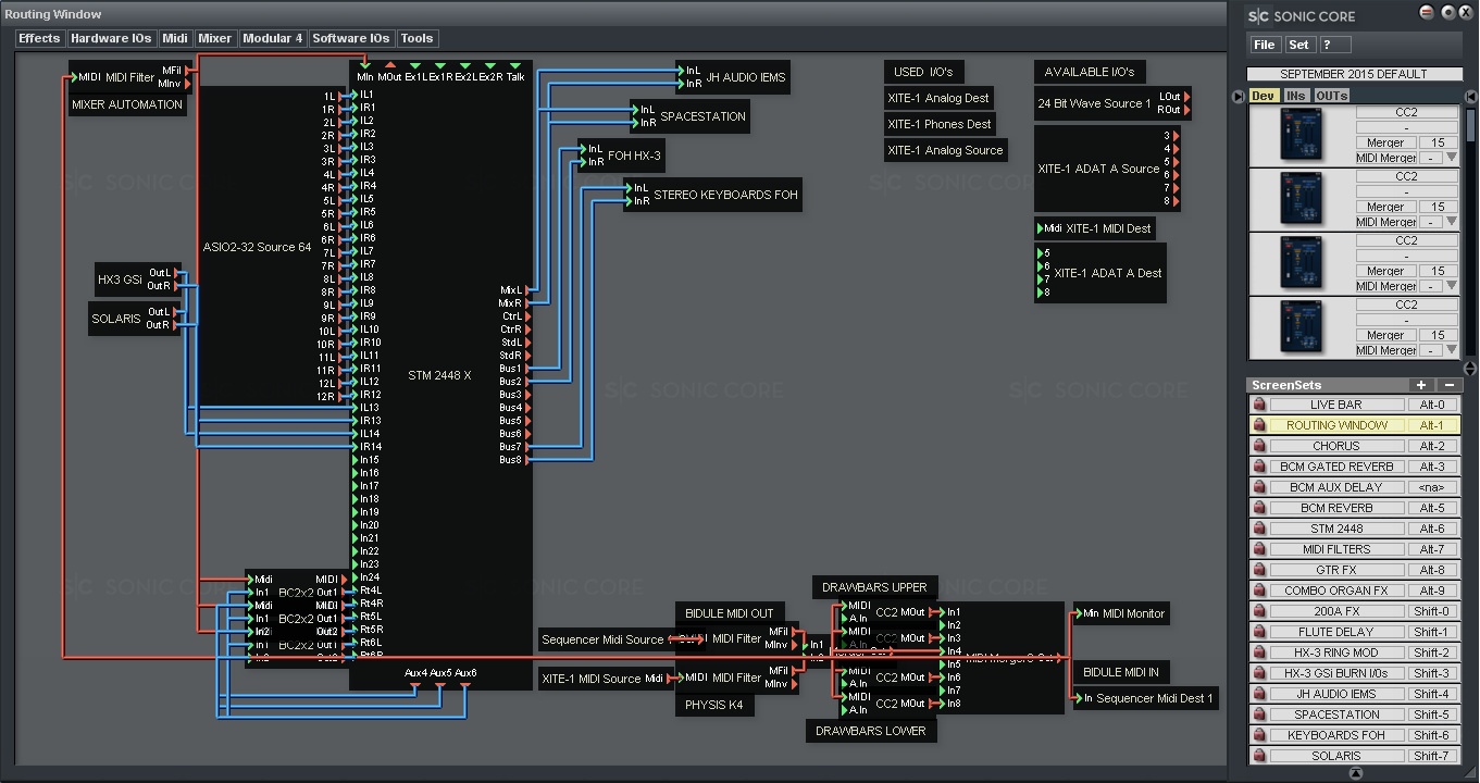

On each screen you post, I can see some strange modules.. For instance, how do you rename your i/o module ? Like "Solaris", "JH audio IEMS", "spacestation" and so on ?
How can you have only aux. 4, 5, 6 on the STM mixer ??
How do you do that, Jimmy ??
I want to do that too ! Names are essential with xite : there are so many modules !
- Posts: 1638
Re: LIVE 2015 ...NEW HARDWARE
Look in Tools/external devices, and you can alias any hardware I/O, save as device, and even use as an insert if you save to the effects directory. This name shows in the routing window.

Woah ! I never used any module in that directory ! And I never new this was possible and worked like that ! I thought 'save as device' was a feature totally disapeared with Scope 3 or 4, don't remember...

Here's the new update using a Radial Plexitube I got for 99 bucks on ebay.
1 mans trash is another mans treasure....
Was using the Organ Module into the GSi Burn (Leslie + Tube) and it gets a real decent
Kansas/Uriah Heep by turning up the drive amount on the HX-3 and running lots of Tube
Gain on GSi Burn.
But it still didn't get the Deep Purple/Jon Lord sounds like he got using a Marshall
Amp Head.
So after trying different pedals at a Pedal shop in Nashville I found exactly what I needed
but wasn't about to pay 350 bucks, so the used one showed up today and I redid a little work
on routing in the XITE-1.
Now I just go from Hard Rock to Blues to Jazz using the GSi Burn or rip off peoples faces with
the Plexitube from Radial.
Also show the notes from Wolf for free at his web page, and how I use the stock Scope modules.
All are recallable using Screen Sets and shortcuts for fast viewing when performing.

Man, that looks great !dawman wrote:Here's the new update ...
Leaves the question how you managed to make only AUXes 4, 5 & 6 visible in the STM 2448 X,- and why you did that (?).

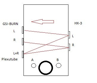

Here's my custom switcher from American Loopers. Great DIY team and top shelf rapid builds and support.

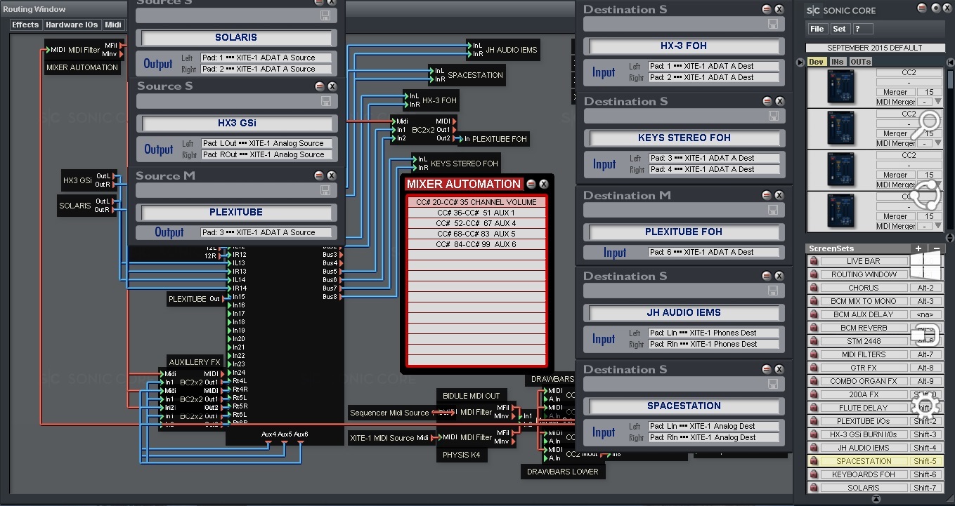

Thanks a lot, JK & Jimmy ! I already set some i/o :
Really convenient !

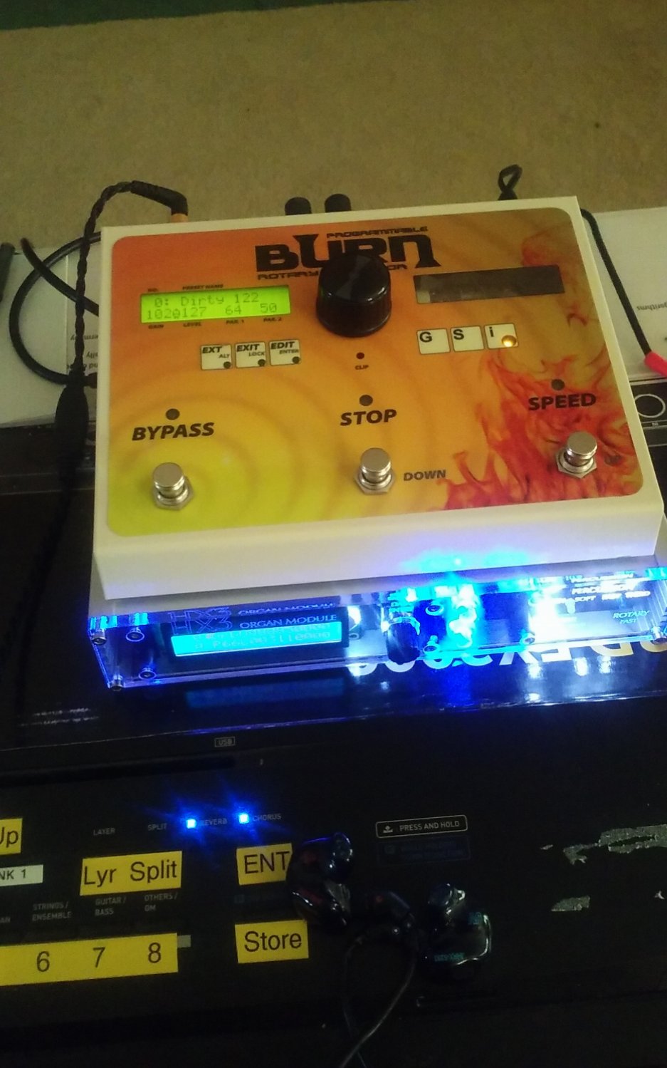

Here's the finished product.
Every Hammond player I ever liked I can now play with these 2 hands free MIDI controlled modules.
Thanks Budweiser for the best Hammond / Leslie 147/122 sound I ever had.
More fun than the real unit since my feet can control every aspect.
And the sound is to die for.
Born To Be Wild, Magic Carpet Ride, Knifedge, Highway Star, Kentucky Woman, Hold Your Head Up.......
So nice to have such powerful and accurate models and the XITE-1 actually has the BX-Digital on the ADAT Destinations to the FOH.
Gets' real wide and everybody, even non musicians were commenting on how awesome this fucker sounds...
