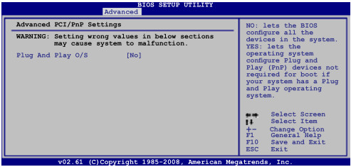

Oops.. Sorry, Garyb... Do you mean it's better to let the OS assigning irqs (But I'm not sure that bios feature is about IRQ assigning, indeed) ? Untill now, it is the bios that does it.
I show you the bios screen :
So ? I set 'yes' or 'no' ? That IS the question ! :D

Re: Asus & plug & play
just leave the plug-n-play settings alone in the default position!
the os will take control of these setting in any case. the message in the bios is generic. newer versions of windows must be in control.
the setting will not fix the shared irq issue. there is no way to affect that except for changing slots or disabling unused devices.
current motherboards require ACPI, which will result in the os controlling irqs regardless of the plug-n-play settings. these settings go back to win95 and earlier. they might affect some Linux or custom os installs, but they should NOT be changed for newer versions of windows.

All right, garyb. I leave it like this ; you certainly know that computer stuff better than I do.
Thanks a lot. :)
sure. i doubt it would explode from changing the setting. it just isn't likely do do anything good. :)
