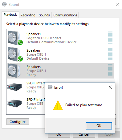

Damn, one small issue, the WAVE SOURCE does not work.
Project is at 48KHz, windows audio is at 48KHz as well, but it fails to play the windows test tone at the property page.
Logitec Headset is working fine.
Anyone a solution?
Thnx Tom
Anyone a solution?
Thnx Tom

Re: XITE 1 with Windows 10
I've two wavesource drivers installed, so I see 2 xite1 speakers in the windows playback devices settings.
When I 'TEST' both of them, I will get the attached message (and no sound is played).
- Error.png (36.68 KiB) Viewed 9694 times

do you have 24bit wave source and destination modules in the routing window?
if not please try them. two of each.
otherwise, we can try a Teamviewer session. i do know that others have had the same problem, but then had success.
edit-
nevermind. another user has the same problem and i couldn't find a fix. i've forwarded the info to Holger.
it's strange because i had been told that everything is working by more than one person. well, it's ASIO for now it seems.

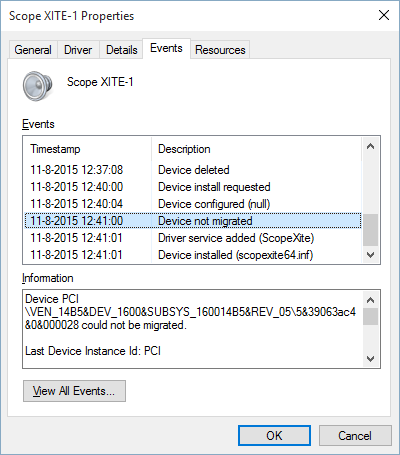

I have the same WDM problem with my PCI cards after upgrading to Windows 10. (ASIO is working.)
In Device Manager / Sonic Core properties the devices are listed as functioning, but if you flip over to the Events tab you can see the message "Device not migrated". You can see the same message in Speakers properties.
There are other HW brands that are experiencing the same thing right now, and MS recommends installing driver setup in compatibility mode, here:
http://answers.microsoft.com/en-us/wind ... d97eb56e13
I've tried this with driver signing turned off but I made no difference.
It seems that the devices have been flagged as "not migrated" and the OS remembers it.
Driver signing was supposed to be even stricter in Windows 10, so what now..?
I ofcourse did that, but then still you need to turn driversigning off to make it work.garyb wrote:driver signing turned off?
no, of course that didn't work. i was suggesting installing in win8 compatibility mode.
Anyway installation in compatibility mode works fine, but still the same problem.
Also the 'Device Not Migrated' message is still appearing in the property window (see attachement).
To be clear, everything works fine (scope software, asio, inputs outputs), only the WAVE SOURCE is not working, so no windows sounds.
