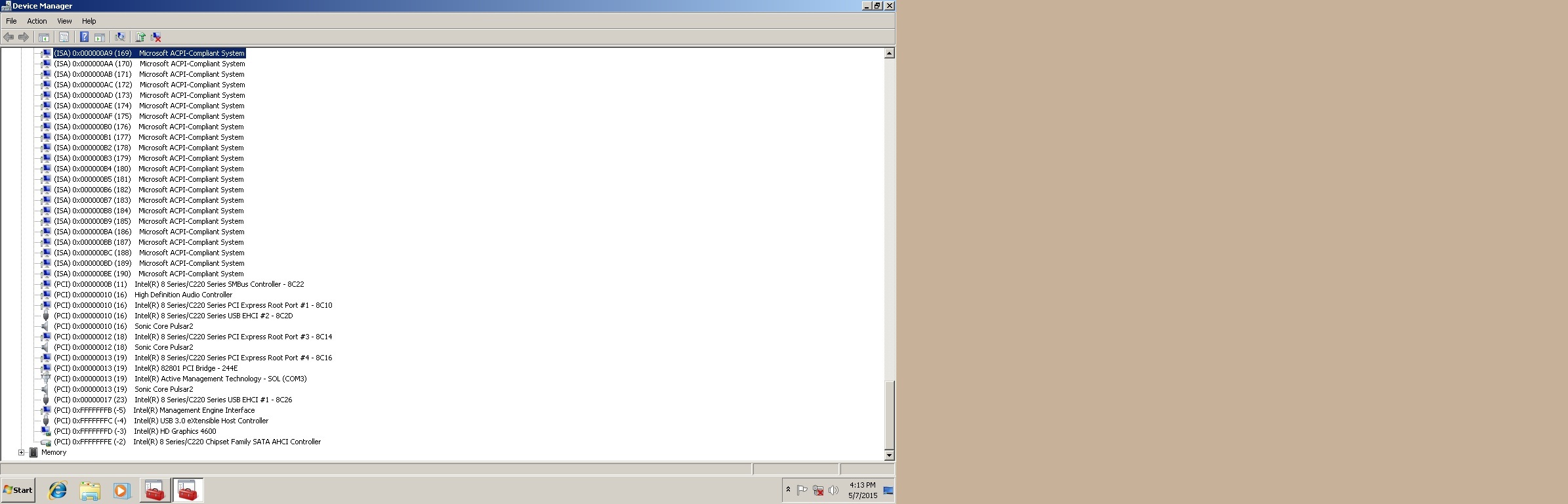

Re: Gigabyte GA-P85-D3 and Gigabyte GA-P81-D3P
Hey Ike, if you could post a screenshot of the (bottom) IRQs in Device Manager for reference, that would be great.
Device Manager > View: Resources by type.
Hi Gary B, Froska etc,
Here is the Hardware;
Titan T850W PSU
Intel Core i5
Gigabyte GA-B85-P3
DDR 3 Ram
2x Seagate Survailance 1TB HDs
Attached is the IRQ bottom page as requested by Froska.
I see an EHCI USB item on IRQ 16. Should I disable that?
That sound strange, however there is no need to disable com and parallel ports, Windows is not going to deliver lower IRQs because of that.
And you don't have to disable the USB device if everything is working, I think most of us need as many USB ports as we can possibly get.
disable the USB port. you can always use a hub, if needed.
as Frokka said, though, no reason to disable serial and parallel ports that i can see. there is also no reason for any issues with the boot drive just from disabling those ports. something else was changed/disabled/disconnected...
Thanks for the advise. The Boot problem was a faulty Ram Stick that failed.
Thats all sorted out now.
The system is working very well no clicks no pops just plain MAGIC.
I will disable the USB port as Gary advises.
