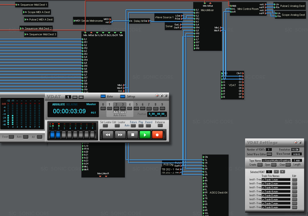

this is my setup.
i have also tried to push the auto and every other button...
the files are always all without audio, completely silent

Re: how do I use the VDAT??
. What OS are you running ?
. OS 32 or 64 bit ?
. What permissions are set on the folder you set as output for VDAT ?
. Do files get written there after recording ? EG when you say files are empty do you mean they exist but are zero bytes length ?
. Does same thing happen if you remove said files and recreate tape in VDAT ?
. Are you running Scope as admin ?
bosone
Posts: 1530
Location: Italy
Post by bosone »
dante wrote:. What OS are you running ?
. OS 32 or 64 bit ?
win7 64 bit
don't know, I don't have any special permissions on my PC!
no, actually they are zero bytes length!
yes
yes, i have tried but nothing changed
in any case i think i will just give up, it's not so imporant for me!
