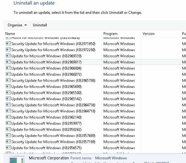

Re: Windows 8.1 64bit Scope 5.1 "Can't find DSP file..."
It cannot be uninstalled if you have a Win 8.1 DVD that was created after the patch was built into the base install.
Fidox, has this install. Other users (such as myself) do not.
If you know where such an installer (Win 8.1 pre April update 2014) can be downloaded, please point me to it.
Watch the 'Uninstall' link ( next to the word 'Organise' ) dissappearing when the KB2919355 is selected
no_uninstall
no_uninstall
