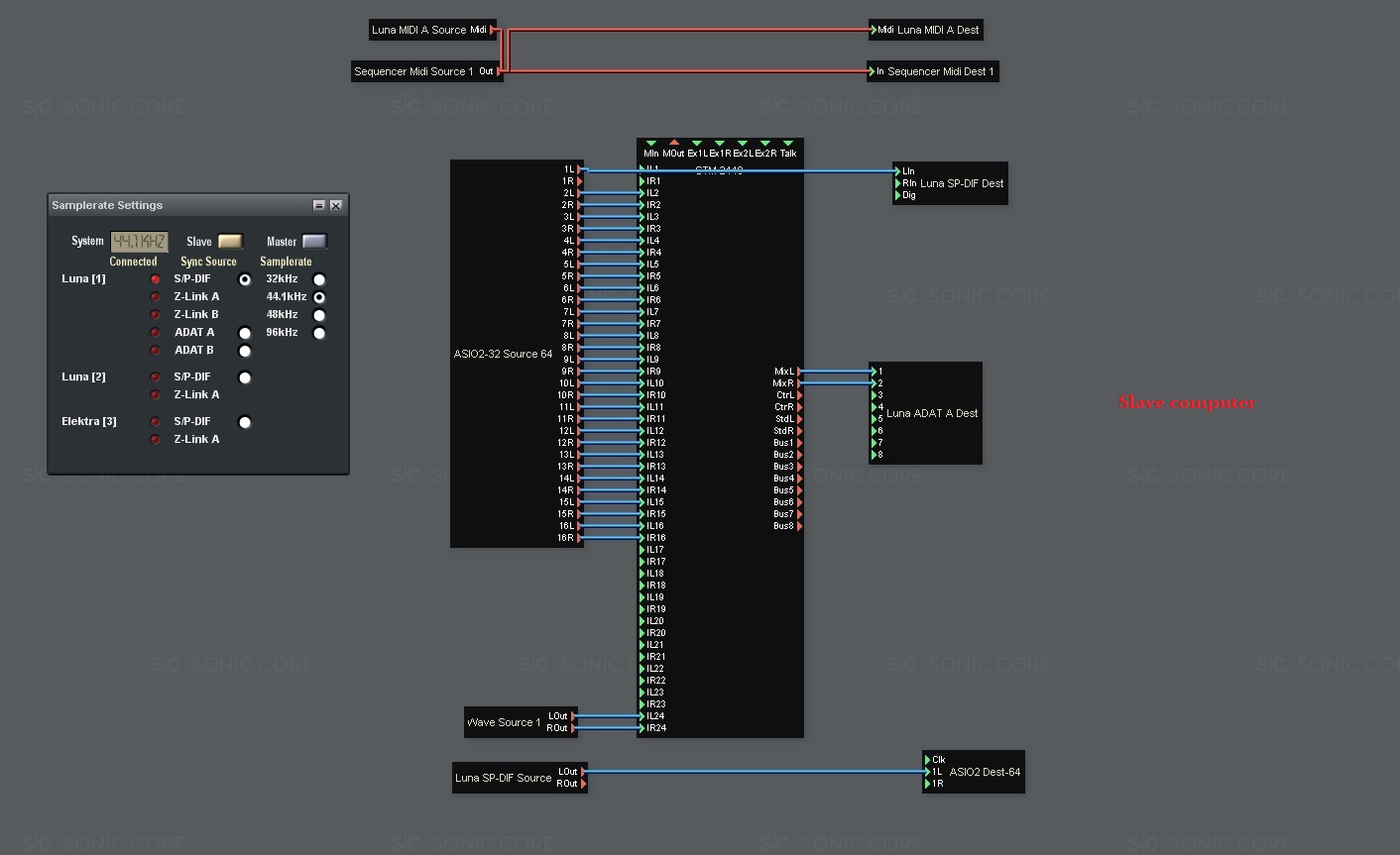

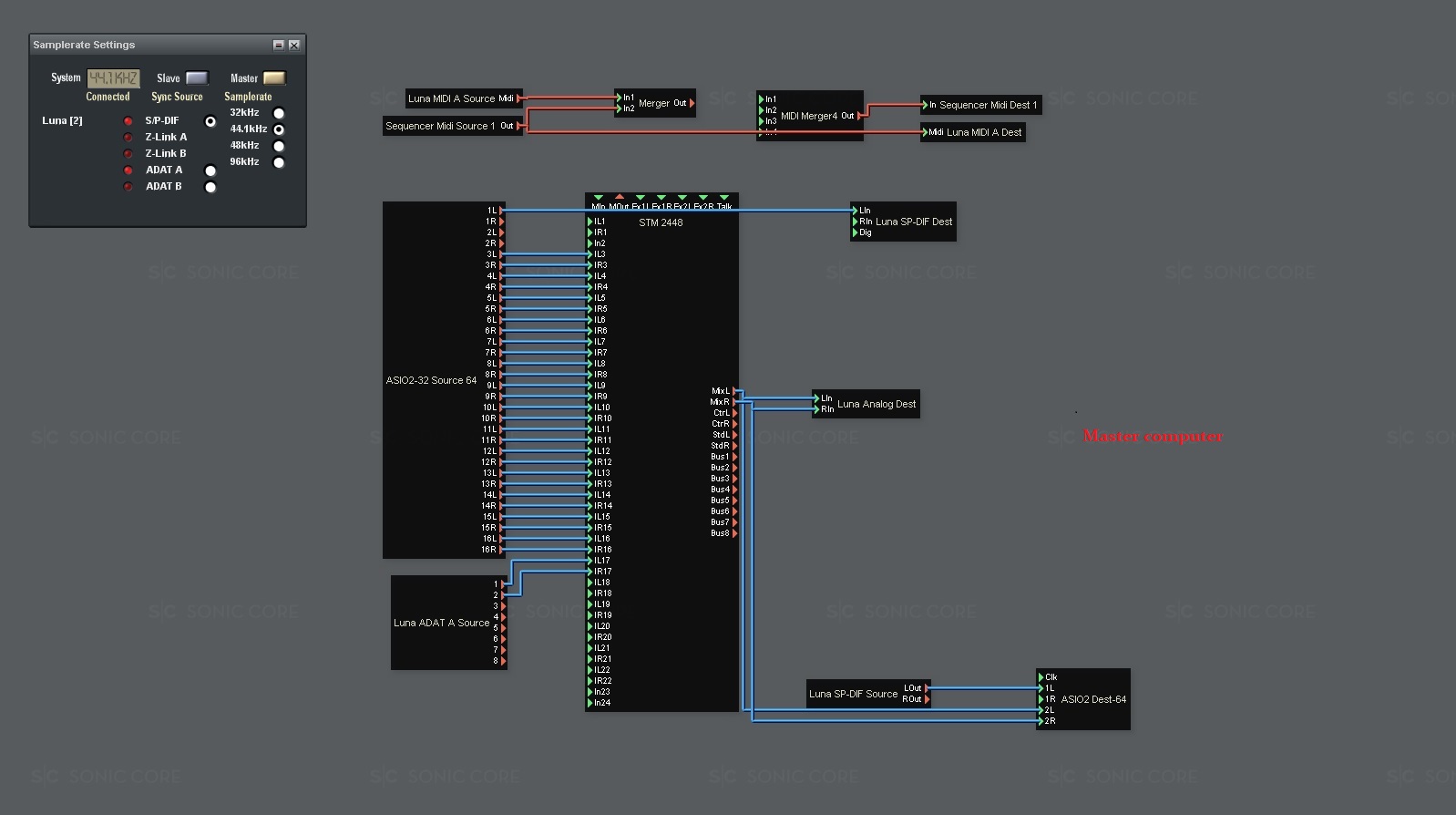

Ok, finally have 2 x Luna ADAT Expansions
I'm little curious now about my connection and if this make any differences.
I have connected 2 computers (synced) over VST system link, running Cubase sequencers on both computers.
My current setup connection is :
-synced over S/P-DIF in/out (from Luna II to Luna II)
-recording signal from slave computer over ADAT to master computer
Is there any difference, if using ADAT for synced computers (maybe more accurate) and S/P-DIF for recording signal or is it the same ?

The main difference between ADAT and SPDIF is the number of channels - so I would think no difference at all unless you want to record multiple channels at once.
