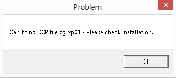

Posted: Fri Jan 09, 2015 4:25 pm
When I try to load up QWave SE on my PCI cards, I get the following error :
zg_xp01 missing
zg_xp01 missing
Ive looked for the file, bat cant find it. Anyone know where it is ?

by jhulk
when you load the instruments from the installer you need to make sure the folders are correct i finding them in the zarg synths it does folders like creamware rather than scope pci
so that the dsp file will be in creamware/dsp folder
i had this type problem with installing both the blackboxii modualr modules and the flexor modules that when trying to use them i had to locate the dsp files every time
in that i started to unzip and manually put the dsp files in dsp folder and presets in presets and putting the files in the correct folders myself rather than using the out of date installers
so i make it a matter of coarse for the zarg synths to actually go through each folder and find the direct files and put them in there correct locations
Re: Quantum Wave on XITE
Posted: Fri Jan 09, 2015 6:45 pm
I did a search on entire C: drive - Scope PCI and Scope XITE and could not see zg*.dsp anywhere

Are you on Win 8.x 64bit? If so I thought there were 64bit Zarg files. I don't remember if one came out for QWSE though.
Posted: Fri Jan 09, 2015 7:44 pm
by guppy
I got the same dsp warning with QWave SE with my xite1
Posted: Fri Jan 09, 2015 9:50 pm
yayajohn wrote:Are you on Win 8.x 64bit? If so I thought there were 64bit Zarg files. I don't remember if one came out for QWSE though.
Yes, Win8 64 bit - I have updated with the zarg64bit files. All the other Zarg synths work.
Has anyone got the file (zg_xp01.dsp) ?

if the require dsp is needed it should be included in the install
so check the zip file for the zarg synths check the dsp folder and see if its in there
as with most installs there is a info text that tells you how to load the devices
and if any dsp required files needed

Dante I will check when I get home on Monday if someone doesn't get to it before. I am still on WinXp so not sure if I can help. Just curious if you have tried to open it since upgrading to 64bit. I think I remember after the Zarg bundle deal the 64bit files came out but QWSE wasn't included in the bundle so that is why I suspect it might be a 64bit issue.

I have the same problem with the qwave se downloaded from the sonic core ftp server, tried it on win 7 64 bit, win 7 32 bit, win xp 32 bit.

Here ya go...
zg_xp01.rar
(2.28 KiB) Downloaded 385 times
Posted: Sat Jan 10, 2015 12:24 pm
by djmicron
thanks,
it works.
It should be included inside the package on the ftp site
Posted: Sat Jan 10, 2015 12:54 pm
Yes fixed for me as well now. Thank you very much RP_001.
