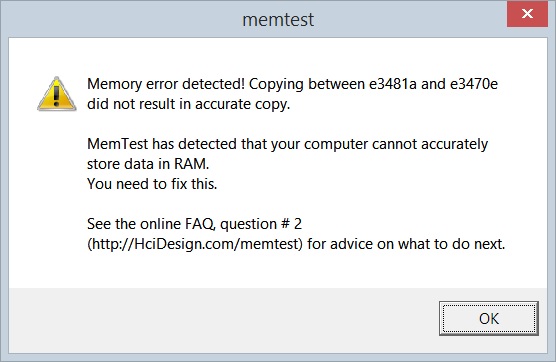

				Just as I suspected:
- memtest.jpg (52.23 KiB) Viewed 10612 times
I order new Ram sticks so hopefully i can get to use these modules, really miss my Scope songs.
