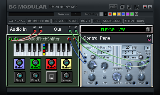

Re: BC Modular v0.98b Now Available
Ankyu..
BCFX SHELL.png (120.69 KiB) Viewed 11272 times
