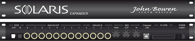

Re: NEKTAR configuration
Maybe JB should make a Solaris in a rack module version ( w/ external ribbon cont thrown in ) with brushed metal black finish. Might be easier than adding triple sensor weighted keys, inbuilt 8x8 MIDI Hub, independent USB, sliders and stubby holder to the keyboard version ...
