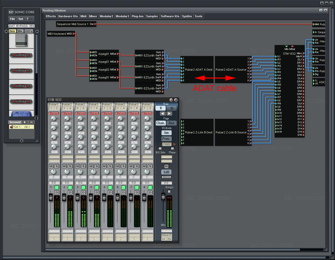

Re: How to test Zlink without Zlink-IO-boxes?
Post by readymedia »
Bypassing the ADAT ports (ADAT Destination and ADAT Source) with an optical cable works fine. See attached picture. Still afraid to do it with electrical Zlink/Firewire bypass...

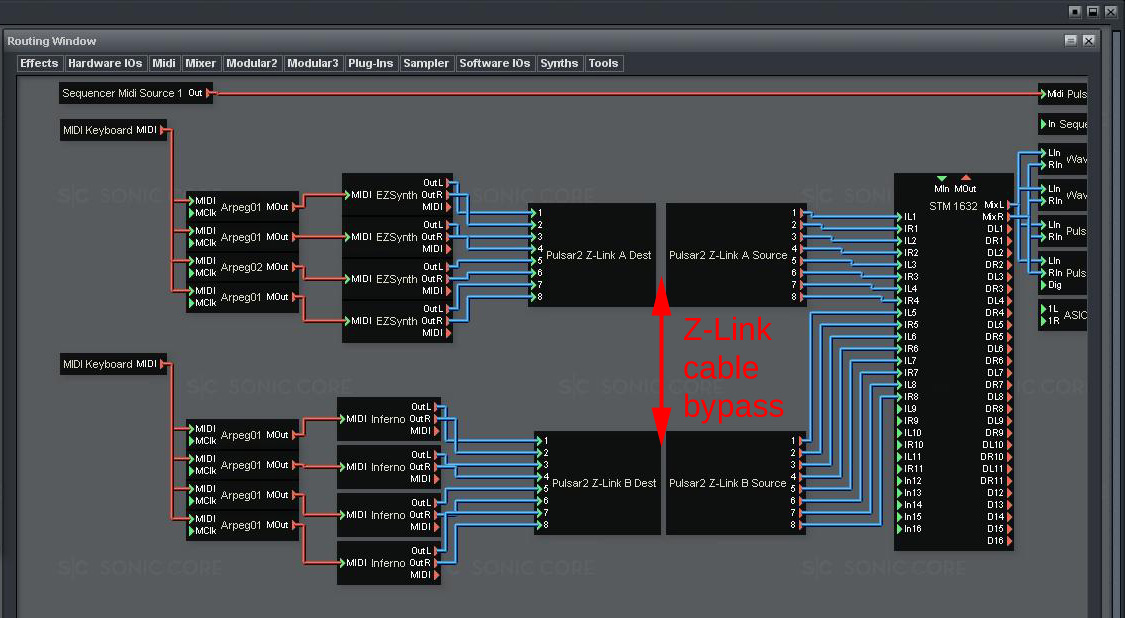

Should it works like this? Or I'm going to fire up the firewire like Z-Link interface with a bypass? Note: The floppy power connector on the Z-Link/ADAT plate is not connected at the time.
i don't think i'd try that...
Yes, I'm also scary about the consequences... It works at the software site, so there is no premise for hardware failure, I think.
well, there's power on the z-link line. that's my only concern.
Post by Immanuel »
I think somebody once tried to hook up two Luna cards through Z-link and fried the Z-link and/or the card.
