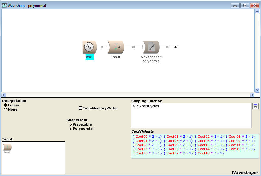

Re: chebyshev polynomials for waveshaping
Hi Ken,
I only can give you this Kyma answer atm. Hopefully it adds something for you.
This is what Kyma says:
Waveshaper
The Input is used as an index into the table specified in ShapingFunction (if ShapeFrom is set to Wavetable) or as the input to a polynomial whose coefficients are those listed in the Coefficients parameter field (if ShapeFrom is set to Polynomial).
Unless the ShapingFunction or polynomial is a straight line, the Input will be nonlinearly distorted. The distortion adds harmonics to the synthesized or sampled Input. Since polynomials tend to be close to linear around zero and less linear the further they are from zero, low amplitude Inputs will be less distorted than high amplitude Inputs. This tends to match the behavior of physical instruments (which sound "brighter" when played louder) and also of electronic components like amplifiers which produce harmonic distortions of their inputs at high amplitudes.
A Waveshaper can also be used to map non-signal Inputs to new values according to the ShapingFunction or polynomial. For example, if the Input were a Constant whose Value were !Pitch, the full range of MIDI notenumbers could be remapped by a Waveshaper to frequencies of an alternate tuning system as stored in a table (the ShapingFunction).
Input
This Sound is used as an index into the ShapingFunction (or as the input into the polynomial described the list of Coefficients).
Interpolation
Choose whether to use only integer values to index into the ShapingFunction or whether to use the fractional part of the Input value to interpolate between the values actually stored in the table to values that would fall "inbetween" the table entries if the actual values were connected by a straight line.
ShapeFrom
Choose whether to use a function stored in a table (Wavetable) or a polynomial computed on the fly using the Coefficients (Polynomial).
ShapingFunction
Select the wavetable that will be used to map the Input to the output.
Coefficients
Enter a list of coefficients A0 A1 A2 ... An (separated by spaces) for a polynomial of the form:
A0 + A1x + A2x^2 + A3x^3 + ... + Anx^n
where Input is x.
In this field, you must enclose expressions within curly braces, for example:
0 {!Val1 * !KeyVelocity} 0.25 1
FromMemoryWriter
Check FromMemoryWriter when the shaping function does not come from a disk file but is recorded by a MemoryWriter in real time.

- Wveshaper - polynormal.jpg (51.81 KiB) Viewed 1958 times
http://www.rolandkuit.com/
- kensuguro
- Posts: 4434
thanks Roland, cool to see the actual screens. I'm curious how Kyma handles aliasing
