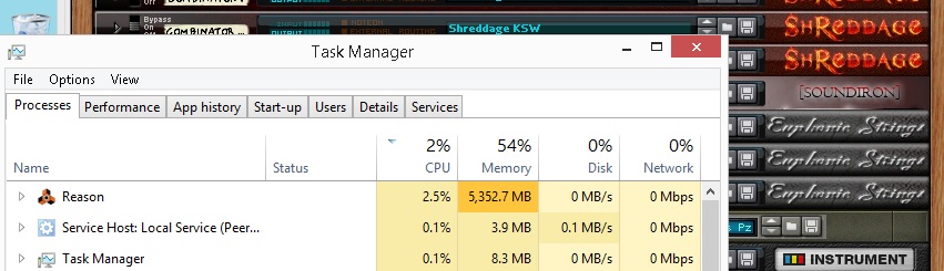

by SilverScoper
garyb wrote:no, NO ONE benefits with 64bit, EXCEPT for the extra ram for Kontact.
Better add Reason to that list. Look ma, no bridges !

Re: Scope v5.1 x64 installed, but it always runs in x32 mode
Posted: Fri Jul 25, 2014 9:08 pm
and Reason...
sampler apps in general...
