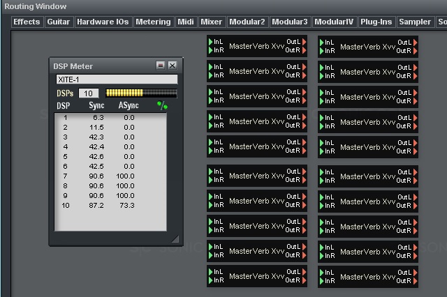

I got bored at loading 20 of these on XITE-1D - so stopped there :lol:
Masterverb-x-DRAM test
It sounds as good as the old masterverb in another mix I did, so well done.

I just like to know what mean a SDRAM verb ? It doesn't use the same memory as the others ?
Thanx for info..........
jhulk
Posts: 935
Re: SAL / Fra77x modules
Post by jhulk »
on the xite there is onboard sdram which means it does not need to use the host ram for the delays
so it will be much quicker in execution less cpu cycles
the new sharc chips can have 5mbit ram on chip now when that chip is implemented that will be mega fast
