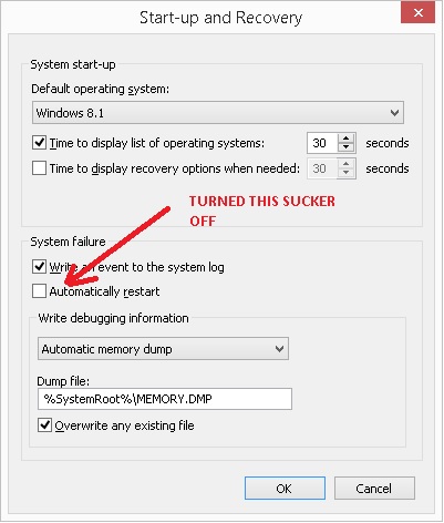

So thats the next thing to try I guess....just to get crash dump.
Re: sys files - issue on latest Win 8 x64
Turned off the auto reboot on crash, now system doesn't reboot on load of sys device, it just looks ok for a few seconds then hangs.
No-Reboot
No-Reboot
Bluescreenview still doesn't capture anything.

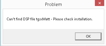

Driver signing had to be turned off to install Scope in the first place, so it was off for a week during which I had the problem. The sys files have worked OK on previous WIN8 systems. ULLI is already at highest latency. Starting as admin crashes. Not starting as admin gets 'Cannot load ....sys' errors and device non operational.

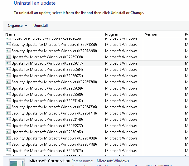

It all started, when i have updated Win 8.1 pro 64bit version with spring update KB2919355.
First , there was an issues "Slow loading-opening folders in Windows Explorer".
There were also other users with this issue, but they don't use Scope platform , they're just Win 8.1 users and not musicians.
So , we manage this to work, mostly with fix , creating new user account in Win 8.1 and it also works for me that time.
Then i installed back Scope and noticed that DASCOEFF11.sys causes me troubles, freezes, no matter what i have done.
I un-installed KB2919355 update and now everything works fine, couple months already, with not a single freeze or similar.

And therein lies the problem for me, since KB2919355 and dozens of other updates are dated the day WIN8.1 was installed from the DVD (27/JUN/2014). I click on it, and the uninstall option disappears. I suspect, on my DVD, KB2919355 is part of the build, not an installable extra.
No Uninstall - Part of DVD image
Cant Load sys file
Cant Load sys file
