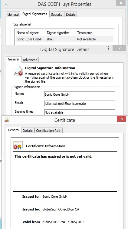

Does it matter if the certificate has expired ?
DAS cert
DAS cert
Re: Life after DAS when theres a Win8 Crash ?
:lol: certificate? no, microsoft was never paid to approve the file. it's not necessary or related.
