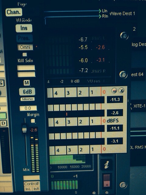

So who do I believe ? Abelton Live says -6db my meters in scope have a different story to tell ..Scope looks like it is agreeing ! Should I just ignore Live

meters are not absolute things. 0db is not the same everywhere as the scale depends on the reference level. believe the Ableton meters in Ableton and the Scope meters in Scope. they don't have to agree, they just need to keep you from overdriving the processes in either system.
harware systems, tape decks and mixers used to have adjustable meters. the engineer was expected to run a reference signal(determined by a specific voltage at a specific frequency) across all of the gear, and then adjust the meters to match each other.

Thanks Gary but still makes no spence to me -6 db is -6db. I am told to mix down to -6db for mastering. Is there any digital meter that is industry standard? I guess as long as there is headroom I should not worry about it :roll:

Posted: Fri Jun 20, 2014 2:55 pm
no, -6db is NOT -6db.
the scale is relative to the reference voltage(which doesn't really exist in digital). -6db is a RELATIVE number, not an absolute number. there is no such thing as an industry standard, although there are two or three reference levels that are most common.
no, you shouldn't worry about it. the only problem is if a digital device shows more than 0db on IT'S meter.

the problem is that decibels are about a measurement scale, but that there's no standard voltage to base the scale on, unlike, say temperature which is based on the freezing point of water at sea level, or some such. usually digital meters agree, but if the Scope card is a plus model, then it's calibrated to a hotter level(+4dBU), while live is probably calibrated to the more common -10dBV(or -20) consumer standard. there may be a preference setting...
heck, in the audio world, there's not even agreement on which pin of an XLR connector is hot and which is cold. most things are pin2(USUALLY the tip in a phone plug) these days, but it was only a few years ago that all american consoles and amps were pin2 hot and all british consoles and amps were pin3 hot. to add to the confusion, QSC used to use RING hot for 1/4 trs plugs. it's no wonder that people who didn't know what they were doing would get things out of phase and short out inputs so no sound came out and all kinds of problems. the meter issue isn't much of one, just make sure that nothing overdrives all the way to the end of the chain.
also, trust your ears over the meters. often there are transients that the meters won't show. the meter at the end of the chain is important because it shows the peak level the limiter is allowing, but again, critical listening is the key to a good job. if the meters are ok, but you hear graininess or other signs of possibly unwanted distortion, then fix it even if the meter is happy. a meter is a general tool, it's not really a surgical one.
