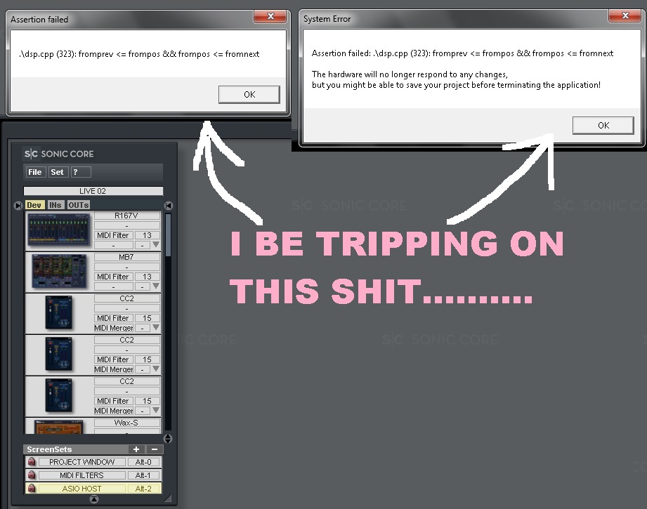

ANy idea wassup?
I opened the rack, but has been working all day, then saw these messages
and unplugged everything, replugged in it, re connected the PCI-e 1X
Connector card, re installed Scope.
I am thinking a new Scope PSU perhaps...?

Her's the latest error message which is tripping me out as I am using an invalidated version of W7 After re installing 7 6 weeks back they are trying to extract more cash as the serial number on the !u rubbed off, so I ain't paying this ongoing criminal enterprise any more money, if I do I will just get 8 instead of paying twice for 7. But I doubt this is a problem as I have used it in this way where it asks for activation for a while now but still does the basic functions like audio, but has an ugly black screen unless I change it all the time, eye candy is what they take from us I believe.
Untitled 2.jpg (19.05 KiB) Viewed 1875 times

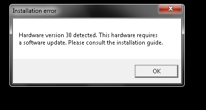

What is also odd is that before, everything would load up, and then the access to hardware after foment schlieben whatever the germen written message read, would should up then say hardware not able to connect.
Now it goes right to hardware 30 message immediately.

dawman wrote:Her's the latest error message which is tripping me out ...
I´ve seen that message too ... :lol:
And several others more ...
At least, it was all BS and disconnecting the HDMI cable from PCIe card, re-seating the PCIe card and re-connecting the HDMI cable on both sides,- computer and XITE-1,- did the trick for me.
I doubt your computer or OS has anything to do with thes messages and malfuctions, I´m pretty sure it´s the cable or the PCIe card if you tried all the dis- and re-connectiong already.
So, grab your existing HDMI cable, go intoa shop and buy some identical replacement.
If that doesn´t work, you probably need another PCIe card for a test and if both PCIe cards don´t work there´s probably a issue w/ the XITE-1 box.
Let´s hope for it´s the HDMI cable !
good luck

the error messages aren't very intelligent. they're generic.
the first set related to the Scope software losing contact with the XITE while it was running. the last message indicated that the Scope software couldn't communicate with the XITE during startup when the software does a diagnostic.
