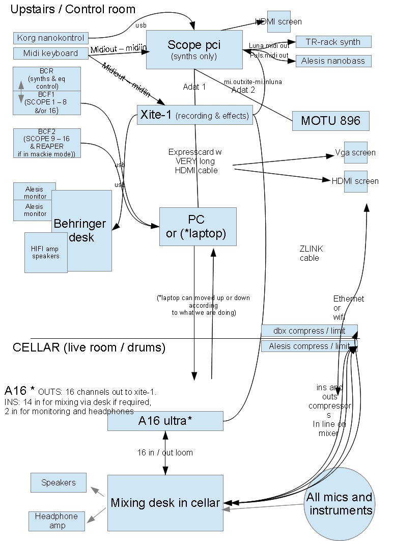

thanks - and a good question - basically i have two rooms....and want to be able to only have to move the laptop when i work in the other room rather than having to move everything....so i thought that running a long cable into my other room might be the most obvious solution which also saves me having to set up a 2nd pc just for remote desktop etc..
see attached file to see what i mean - top half is my ' control room', bottom is my 'live room' cellar...i sometimes do my own drum playing recordings donwstairs alone so need to be able to control the xite1 when downstairs..a case of wanting my cake and being able to eat it..anywhere
when you tried the 5 meter test did you use a specific ' quality' brand of hdmi cable, btw?
- scope connectivity w laptop.jpg (191.03 KiB) Viewed 3364 times

No particular brand, however make sure it is a "High Speed" cable, not "Standard". These designations are made by the HDMI standard, and aren't just marketing crap.
I now have three cables: The one that came with the XITE (black & red cable, with RF chokes at both ends) (~1-1.5m), a longer cable for my studio setup (laptop on desk, XITE in rack behind me)..about 5m cable. And the third (~0.6m) is when I take that same rack live...it is meant for a DSLR camera, and has a 90deg bend in it, so there is less stress on the cable (and less likely to be knocked out on stage!). It's not great, because it is the coiled type of cable...which isn't the best for routing through a hole into a rack.
If you can find one, it won't hurt to try out a 10m cable. The worst that would happen is you'll get some disconnects eventually, but no damage would happen.
