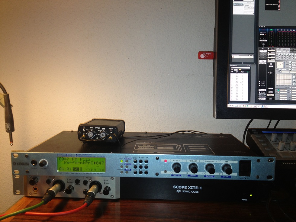

Re: Scope FS1R - Now with an interface to match the sound
So how do you like the ZeeEdit?
Makes programming a breeze.
Finally decided to get rid of the Microwave 1 and keep the FS1r.
Drug it out with the SE-1X and have a 4U with FS1r and the SE-1X.
Will be using it lots so can share some XITE-1 and FS1r tricks soon.
I like the FX but the Fireworx just rules.
Especially the FS1r Guitar stuff using extra Distortion from the Fireworx.
Cheers
