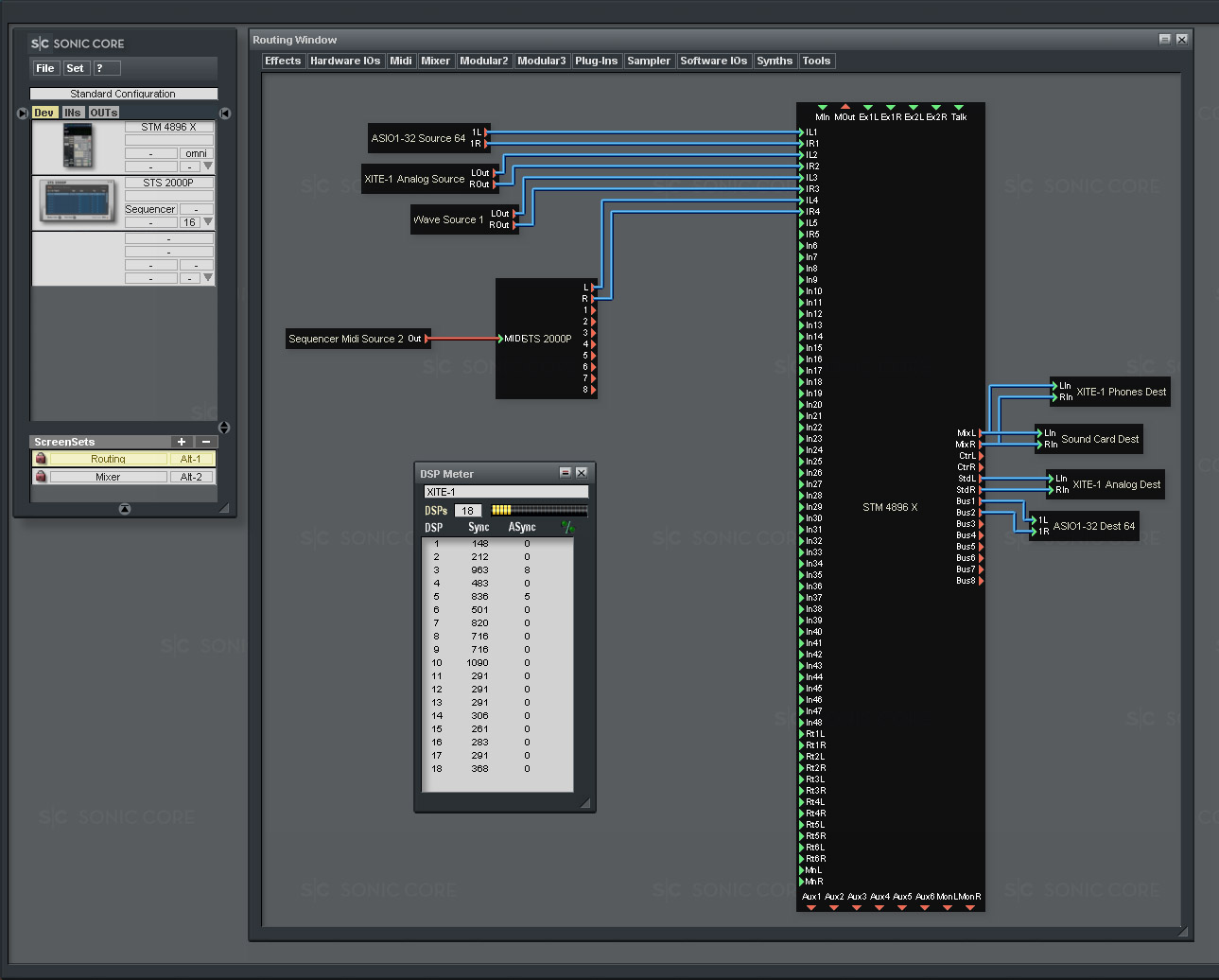

>maybe if you post a screenshot of the project enabled at the time you turn on speakers, it might be more clear what is happening.
I habitually use two or three different projects. none of them tax the DSP capacity of the XITE-1 even 50%. The error is independent of the SCOPE project that is loaded. A snapshot of my usual project is attached. The speakers are accessed through the Analog Destination Device attached to the mixer's [STDL/STDR]

- SCOPE.jpg (218.01 KiB) Viewed 7962 times

I see on your project that you are using the soundcard destination module, which soundcard is involved with it?
