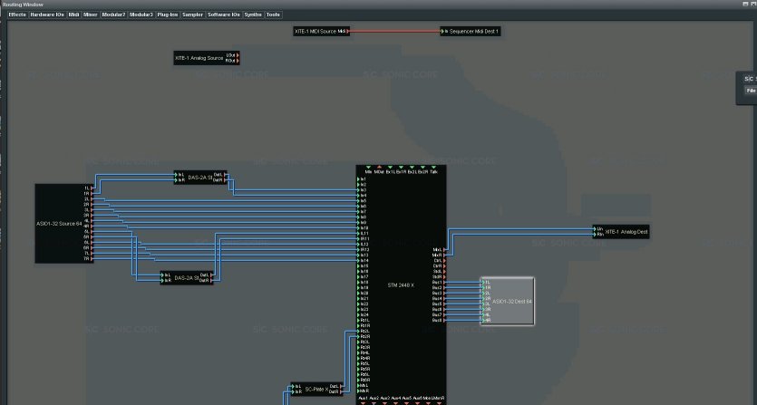

Gary, did you see my other post? My display is also doing a few strange things. One is a strange shadow on the Scope GUI when changing from large projects to another new project , and often I get the PCI capacity message when a heavily loaded DAW project is closed. It's also doing that 'pack of cards' thing when moving a window on screen. I run dual monitors but it only happens in one monitor though, so it could be the VGA side of the video card. The monitor itself seems fine.garyb wrote:maybe your video card is broken.
when a video card dies, it doesn't always stop working. often, it passes signal, it just ceases to do any calculations, leaving the rest of the system to generate the display.
also, cpu meters aren't all that accurate....
It doesn't show anything in the device manager however. According to that it's all working fine.
