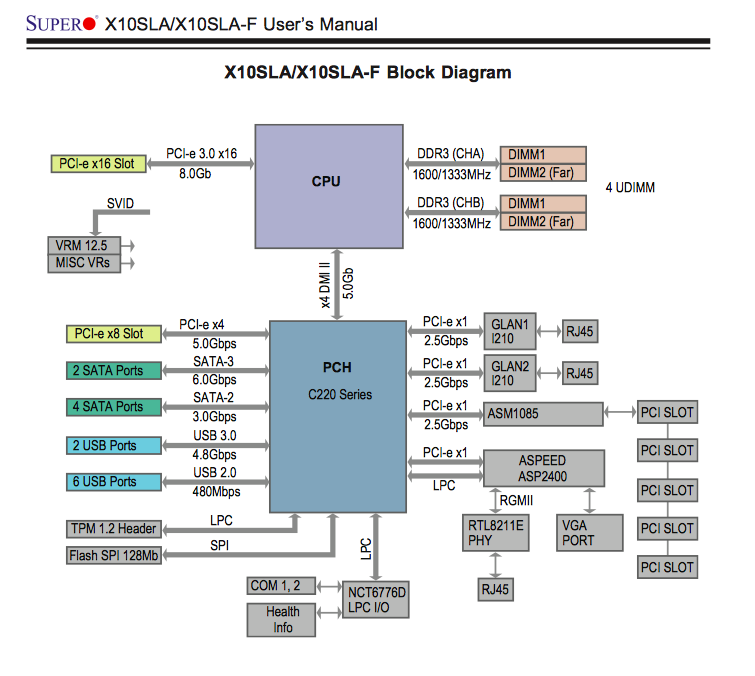

garyb wrote:the cards work in the latest socket 1150 machines very well.
Even with the asm1085 bridge chip? Cos I am currently trying this Supermicro Board, but saw it had a bridged connection and wanted to return it (Yes - before installing programs, and stress testing - cos I already used weeks installing software on another Supermicro board before noticing that it had 3 volt PCI slots :roll: )
http://www.supermicro.nl/products/mothe ... 0SLA-F.cfm
Skjermbilde 2014-01-29 kl. 14.48.25.png (121.62 KiB) Viewed 7325 times

Re: Considering Xite or UAD Apollo - cons and pros please?
Posted: Wed Jan 29, 2014 5:52 am
by jhulk
yep definitely uses a pci-e to pci bridge for 5 slots
i was going to buy that board my self to try
but being a bridge and not direct pci support then there could be sat connection errors due to 5 pci cards on the bandwidth of the pci-e connection plus there bound to be latency because it is another bridging interface rather than direct port
the only way to find out is by testing 1
i at the moment am using a hw6200 which has direct pci interface and its rock solid and with win732bit you can assign 4gb to more than 1 program so you can have the 8 to 16 gb ram fitted
Posted: Wed Jan 29, 2014 6:06 am
by endre70
Yeah i got this sent to my from the norwegian Supermicro dealer. He forgot that I specifically needed native PCI connection. And this after the first board was 3 volt , not 5. Well any who..
It got a 3.6 Haswell and 32 gb ram - if it would work it would be awesome.
I would be using 2 pci slots, but i am skeptical cos all the usb´s and stuff goes thru the same PCH.. Wonder if Gary or anyone else has some experience with this board…
Posted: Wed Jan 29, 2014 11:01 am
ALL motherboards since socket 1155 have the bridge. NONE have native PCI support. PCI is obsolete!
why did S|C go with PCIe for the XITE otherwise?
Posted: Wed Jan 29, 2014 11:39 am
by endre70
garyb wrote:ALL motherboards since socket 1155 have the bridge. NONE have native PCI support. PCI is obsolete!

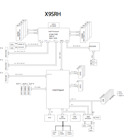

Half truth..I got a 2011 socket board without a bridge but with wrong volt..
Skjermbilde 2014-01-29 kl. 20.33.47.png (43.72 KiB) Viewed 7292 times
Ok thanks Garyb!!!! I take from your answer that the board Im talking about might work. Have you got any experience with this specific board?
Cheers!
